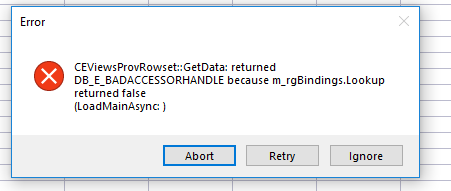

Hello, When I'm using "get data" command in the excel addin I get the following error:
Do you know why? it worked with Eviews 10

Can you provide more details? Specifically, I need to know the exact steps to recreate this issue as it seems to work fine on my machine. Was this during an attempt to import data from a new source or were you trying to refresh an existing connection?

That error can happen if you uninstall EViews 10 and EViews 11 add-in didn't get registered properly.
To resolve this, shutdown Excel, then run EViews 11 and type in REGCOM into the command window and hit Enter. Click Yes(All) to re-register everything. Wait for the success message.
Now restart Excel. After it starts up, go to File/Options/Add Ins. Select "COM Add Ins" in the Manage dropdown and click Go. Make sure the EViews add-in for Excel 2010 is pointing at your EViews 11 folder. If you see others still pointing to EViews 10, uncheck the checkbox for those. Click OK to save changes.
You might have to restart Excel after these changes, but you should now have access to the EViews 11 Excel add-in. Note, we will update the Excel add-in for EViews 11 sometime next week with a few bug fixes and an updated graphic (the current one still uses the EViews 10 graphic for the Get Data button).

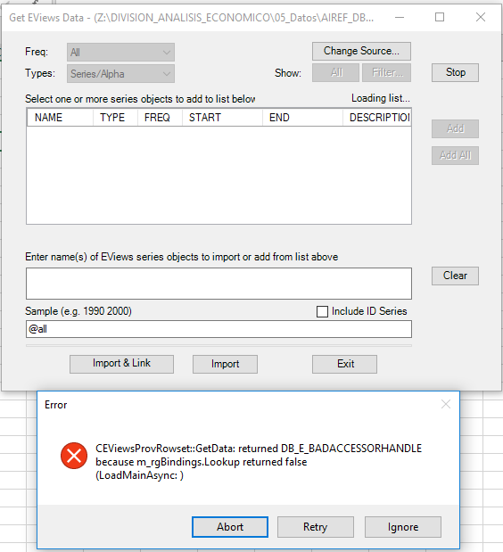

I experience the same issue. I have upgraded to Eviews 11 from Eviews 10 (both 64 bits I believe). The result is the same whether I create a new connection or try to update an existing one.
I followed the steps of re-registering Eviews and making sure the add-in points to Eviews11 folder.
Is there anything else I could do?
Cheers,
Fede

Re: Bug using Eviews 11 and the excel add-in
In addition, a colleague of mine who did the same upgrade does not have such a problem. The only difference in our specifications is the Excel version. He has a 32 bits version and I have a 64 bits version (version 1904).

jfgeli:
We'll be releasing a few small bug fixes to the Excel 2010 add-in sometime this week. However, I don't think these fixes will help your particular case.
When we install EViews onto a machine, we try to make our various components (such as the OLEDB Provider dll which is used by the Excel add-in) available to both 32-bit and 64-bit processes. But there is a performance hit when you have a cross-bit use like that (such as when 64-bit Excel uses 32-bit EViews). So we suggest you install a matching bit-version of EViews to talk to Excel with the best performance. This means if you have 64-bit Excel installed, you should also have 64-bit EViews installed as well. With our licensing, you can have both 32-bit and 64-bit EViews using the same license on the same machine.
Also, installing 64-bit EViews can also help resolve any invalid path in your windows registry that is pointing to, perhaps, an older 64-bit installation path that no longer exists.
If you'd like to resolve this issue without installing 64-bit EViews, do the following:
1. Open a DOS prompt (command.exe) with local admin rights.
2. CD to your EViews 11 program directory (e.g. CD "C:\Program Files (x86)\EViews 11")
3. Type in and run the following command:
4. Wait for success message.
5. If you have an "x64" subdirectory, switch to that folder and re-run the same command as #3 above.
6. If you have an "x86" subdirectory, switch to that folder and re-run the same command as #3 above.
7. Restart Excel and try using the add-in again.
This process basically forces a registration of our EViews OleDb Provider in both 32-bit and 64-bit forms.
Ste
regsvr32 EViewsOleDbProvider.dll5. If you have an "x64" subdirectory, switch to that folder and re-run the same command as #3 above.

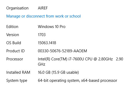

I have an Excel 64 bit version running in my machine. The Add in gave problems ith Eviews 64 bits. I have tried in two different computers (both running Excel 64 bits) with the same results. My Excel version is 16.0.11601.20130 64 bits
However, Eviews 64 bits works well in another computer with Excel 32 bits (my colleague´s computer).
Besides this (small) difference, in the 3 computers we have the same settings (same operating system, network policy configuration, etc).
The way I have installed Eviews 11 was the following (I have admin privileges):
1)With Excel closed, I have uninstalled Eviews 10 64 bits
2)Opened Excel 64 bits and make sure it was not pointing to the COM-Add in from Eviews 10.
3)Closed Excel 64 bits
4)Deleted C:\Program Files\EViews 10
5)Cleaned Windows Registry. I manually searched the word Eviews and deleted all registry entries.
5)Run CC Cleaner to check the consistency of Windows Registry
6)Installed Eviews 11 64 bits
7)Opened Eviews 11 64 bits and run regcom
8)Opened Excel 64 bits
Is there anything I am missing? If possible, I would rather use Eviews and Excel both 64 bits. I attach a screenshot.
Cheers,
Federico

What is your EViews 11 build date? Go to our Help menu/About EViews to see this value.
