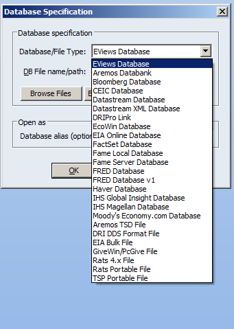

My question is: what will Eviews do with regard to accessing datastream data?
I am saying this since Reuters is telling Datastream clients that it will stop using the old (DWE) Web-services client which was residing here http://dataworks.thomson.com/dataworks
and which was also the same url that Eviews used to query the data.
See the list of available databases from the Eviews pull down menu:
This is the list of databases I see from the Eviews menu
Everything will be moved to a new client, DswsClient , with a slightly different interface and more importantly a restricted functionality data navigator, without a handy(and extremly important) series-picker.
