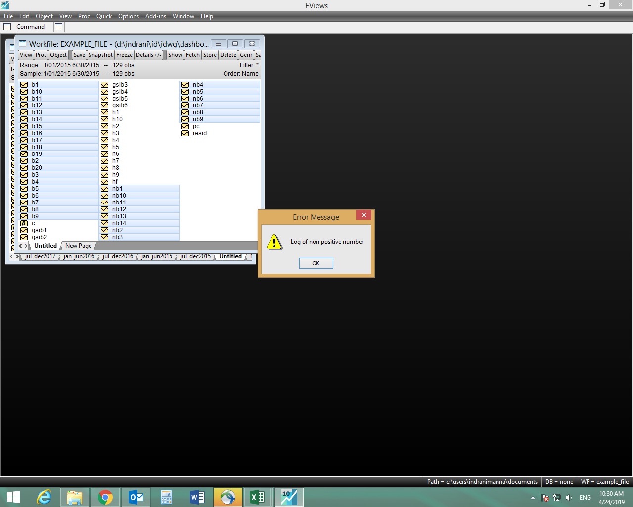

Please find attached the workfile. I am running a VAR with the following variables
b1 b10 b11 b12 b13 b14 b15 b16 b17 b18 b19 b2 b20 b3 b4 b5 b6 b7 b8 b9 nb1 nb10 nb11 nb12 nb13 nb14 nb2 nb3 nb4 nb5 nb6 nb7 nb8 nb9 hf pc
and the message "log of non-positive number" keeps popping up as you can see from the attached screenshot. How do I overcome this problem?

Did u include all the 36 variables I mentioned in the VAR? Inclusion of pc is leading to problems.

I'm able to reproduce your issue with EViews 10. It appears that there is multicollinearity among your regressors, which is causing an internal descriptive statistic to fail (EViews 11 skips this statistic).
