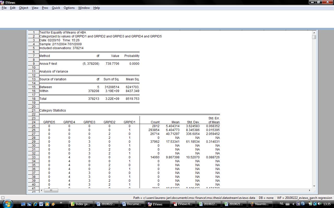

laurensjan
- Posts: 5
- Joined: Tue Feb 16, 2010 9:59 am
Re: Compare subsamples of cross-sections

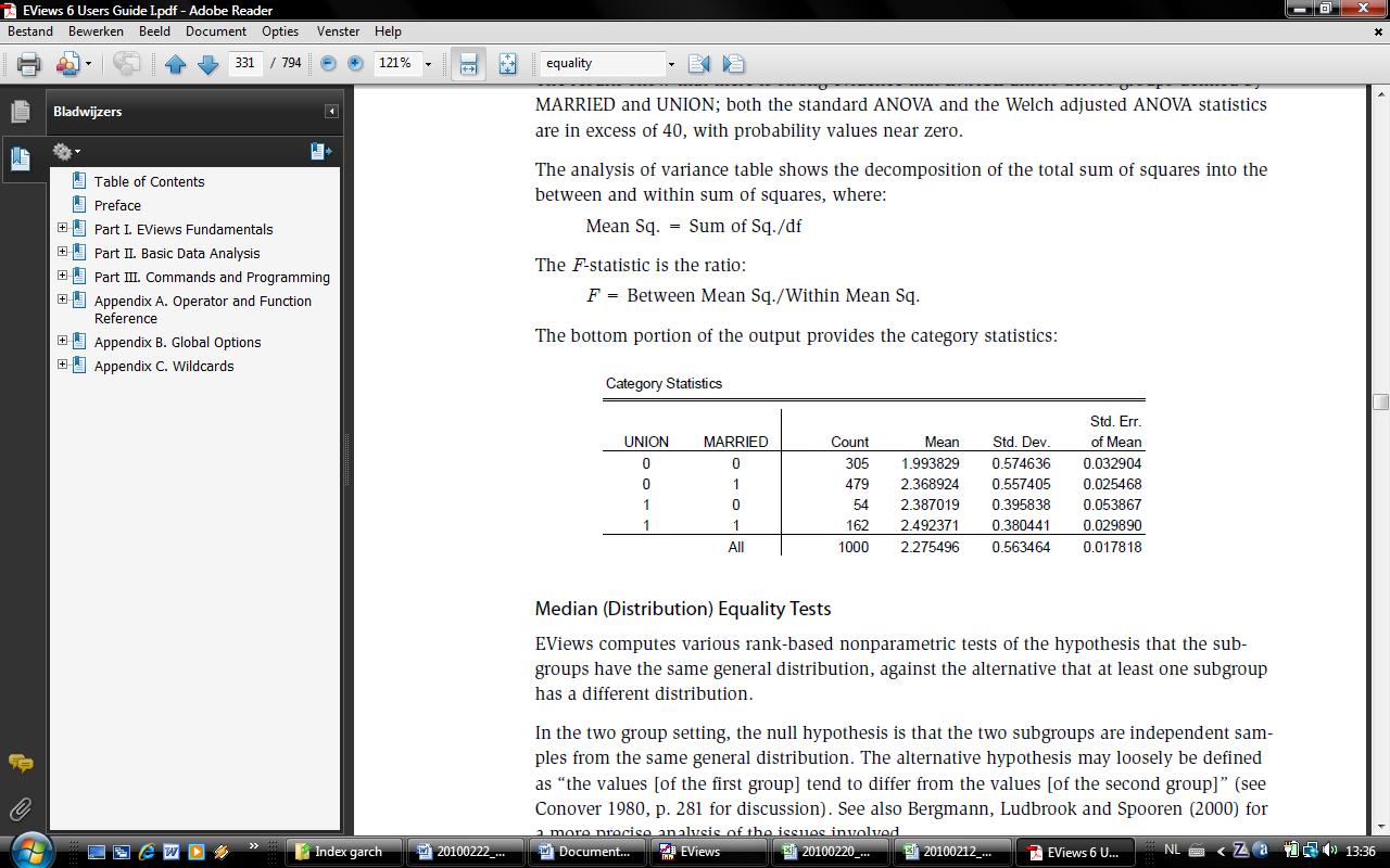

I constructed the second commands mentioned (I have 5 groups and more cross-id's but I used the codes below), since the first option was no solution, thus that is:
What do I do wrong, since I want to compare the subsets with eachother, and not so much with the total. The attachment 'screen2.jpg' shows the screenshot of the Eviews guide, where the comparisons are shown between subsets. What do I have to modify to achieve similar results as in the guide.
Thanks for helping.
It divides the crossid's in 5 groups, only when I perform the equality test, the only comparison that is made is between one subset vs. the total sample. There are thus no subset vs. subset comparisons. See also screenshot of the results in 'screen1.jpg' in the attachment.For your information: there are no cross-id's left when I classified the 5 groups.smpl @all
series grpid = NA
smpl if id=2 or id=4 or id=6
grpid = 1
smpl if id=5 or id=8 or id=9
grpid = 2
smpl if id=10 or id=10 or id=13
grpid = 3
smpl if id=14 or id=1 or id=3
grpid = 4
smpl @all
Thanks for helping.
- Posts: 2682
The null in the ANOVA is that the group means are equal to each other. Note that if they are equal to each other, they are also equal to the overall mean.
