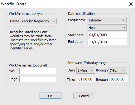

Before I imported the data I have created a new work-file to define the frequency of my data. The specifications can be seen above:
The problem is that Eviews changes the data range from 01:00h-00:00h to 00:00h-23.00h, witch is causing, for example, that the value I have defined in Excel at (for example) 18h at a certain day, appears in Eviews not at 18h but insted at 17h.
