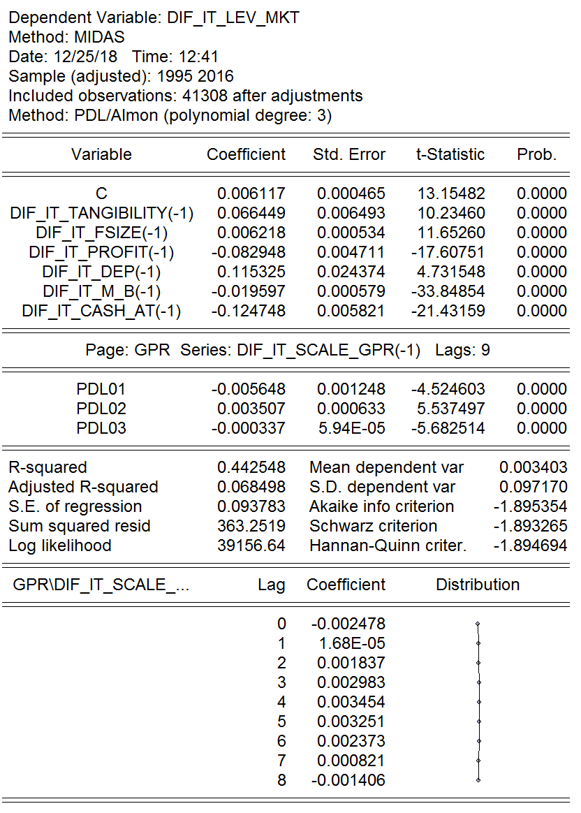

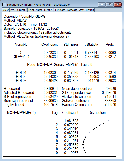

I am currently using MIDAS in Eviews. Looking at the example (see attached) on Eviews web, the estimated result shows the estimated coefficients of the high-frequency independent variables and it starts from lag1 onwards.
Working on my data (see the file under the name of "query"), I couldn't get Eviews to show the estimated coefficients of the high-frequency independent variables from lag1. May I know if there is a way that I can adjust the setting to show estimated coefficients of the high-frequency independent variables from lag1 onwards?
Thank you.

No, we changed the labeling at some point to more accurately reflect. In the bottom picture you should minus 1 from the lag definitions.
