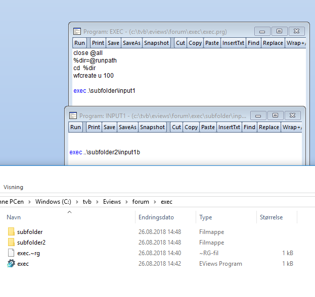

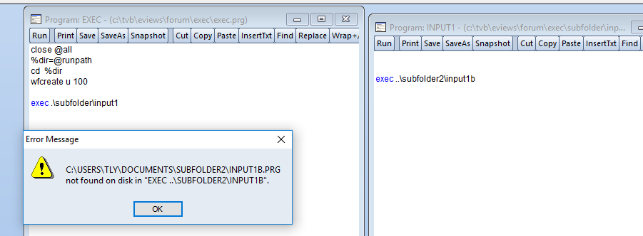

I am struggling with finding the correct path when using the exec command and when the called program is in a subfolder.
i have a program located in a subfolder, and in that program, I would like to execute a program located at a higher level. I thought I could use the code
exec ..\program
but it does not work....
calling a program at the same level as the parent program works fine
exec .\program
see attached example
how can I avoid this problem?
