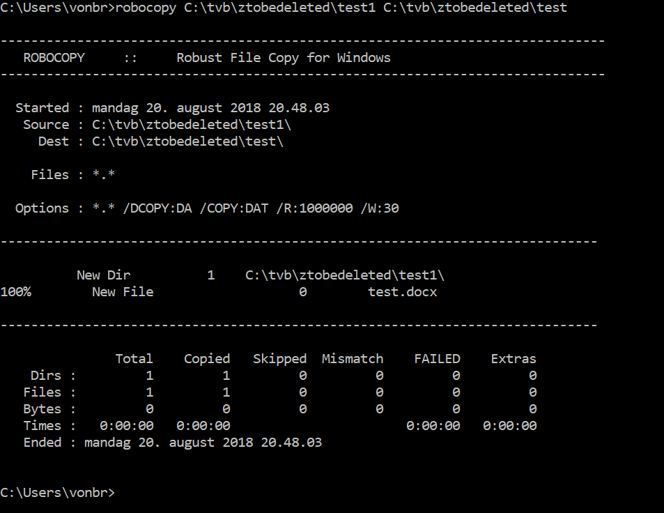

I am struggling with the shell command. When i type
shell robocopy C:\tvb\ztobedeleted\test1 C:\tvb\ztobedeleted\test2
I get the error message
However, when i type the command directly in CMD, the folder is copied without a problem, see
What am I doing wrong?

The SHELL command is similar to SPAWN, but it is hard-coded to look for a specific return value of 0 (if you provide arguments after the SHELL command).
It turns out that ROBOCOPY.exe returns 0 only if no files were copied. It returns 1 if at least one file was copied and so EViews assumed this was a problem (the garbage being displayed as the error message was it showing an uninitialized string). So you should use SPAWN instead so that it will ignore any exit codes.
spawn robocopy C:\tvb\ztobedeleted\test1 C:\tvb\ztobedeleted\test2
If you wanted to make sure that robocopy actually copied at least one file, you could tell SPAWN to look for an exit code value of 1:
spawn(exit=1) robocopy C:\tvb\ztobedeleted\test1 C:\tvb\ztobedeleted\test2
