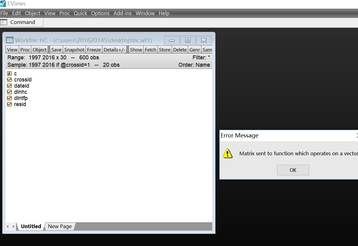

I encountered the same problem as jiangziyaok. When I added the variance decomposition option, it showed a error messages: matrix sent a function which operates on a vector. My data is in the attachment section.
In addition, I don't understand what e1, e2...en in the impulse response diagram is?
Can you give us some suggests?

What is the version of eviews you use? It works for my eviews.
For example, the following command is working:
psvar(ident=1, horinzon=10, vd=1) 5 @ dlntfp dlnhc
You do not need to take the first difference. The add-in automatically will take the first difference.

I use the eviews10. I also use your code "psvar(ident=1, horinzon=10, vd=1) 5 @ dlntfp dlnhc". However, i still shows: matrix sent a function which operates on a vector.
Maybe it's time to change my eviews version. QAQ.

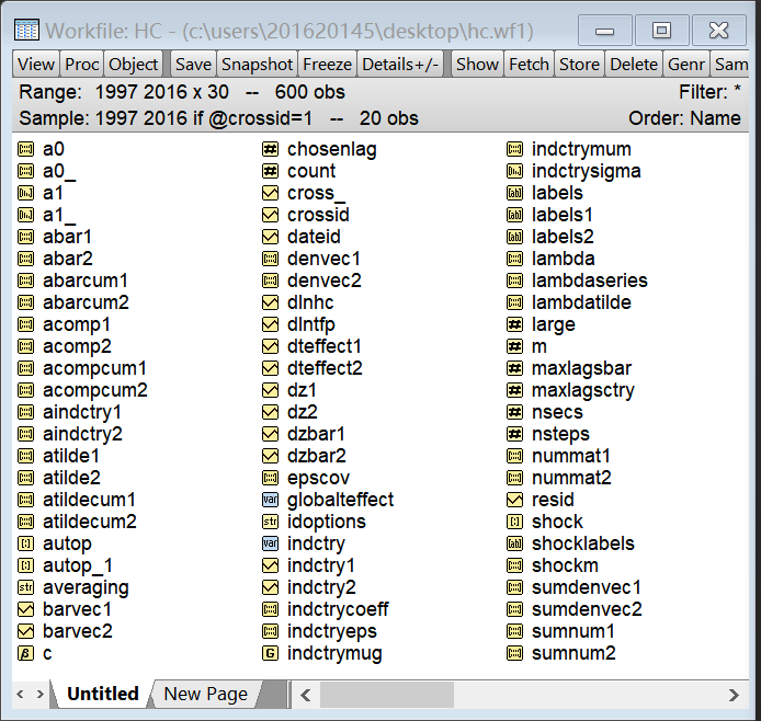

When i click OK. It shows
Perhaps the result of the variance decomposition is in the above picture, but I don't know that it is the end result.
Also, can we do Panel Granger causality test by psvar?

Try to update the eviews 10 and try update the psvar add-in to the version 2.0. It is not possible to do Granger causality test using the psvar add-in.
