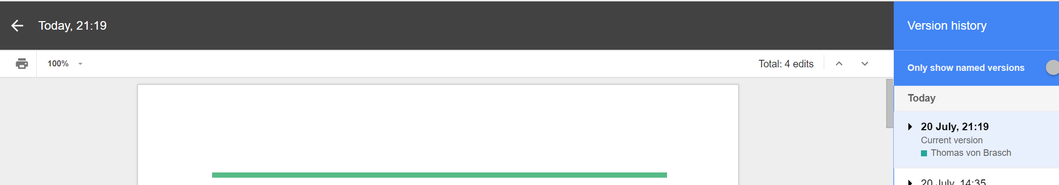

I am not sure what you mean by timestamp, but I made a change at 20.19. this was saved in google docs (see picture below). When i ran the file from EViews, it used an old version of the file. I ran the program several times, and it was not until 20.23 (i.e. four minutes after I had made the change) that EViews downloaded the correct version. When I use the code based on the wget command, it fetches the correct version immediately.
