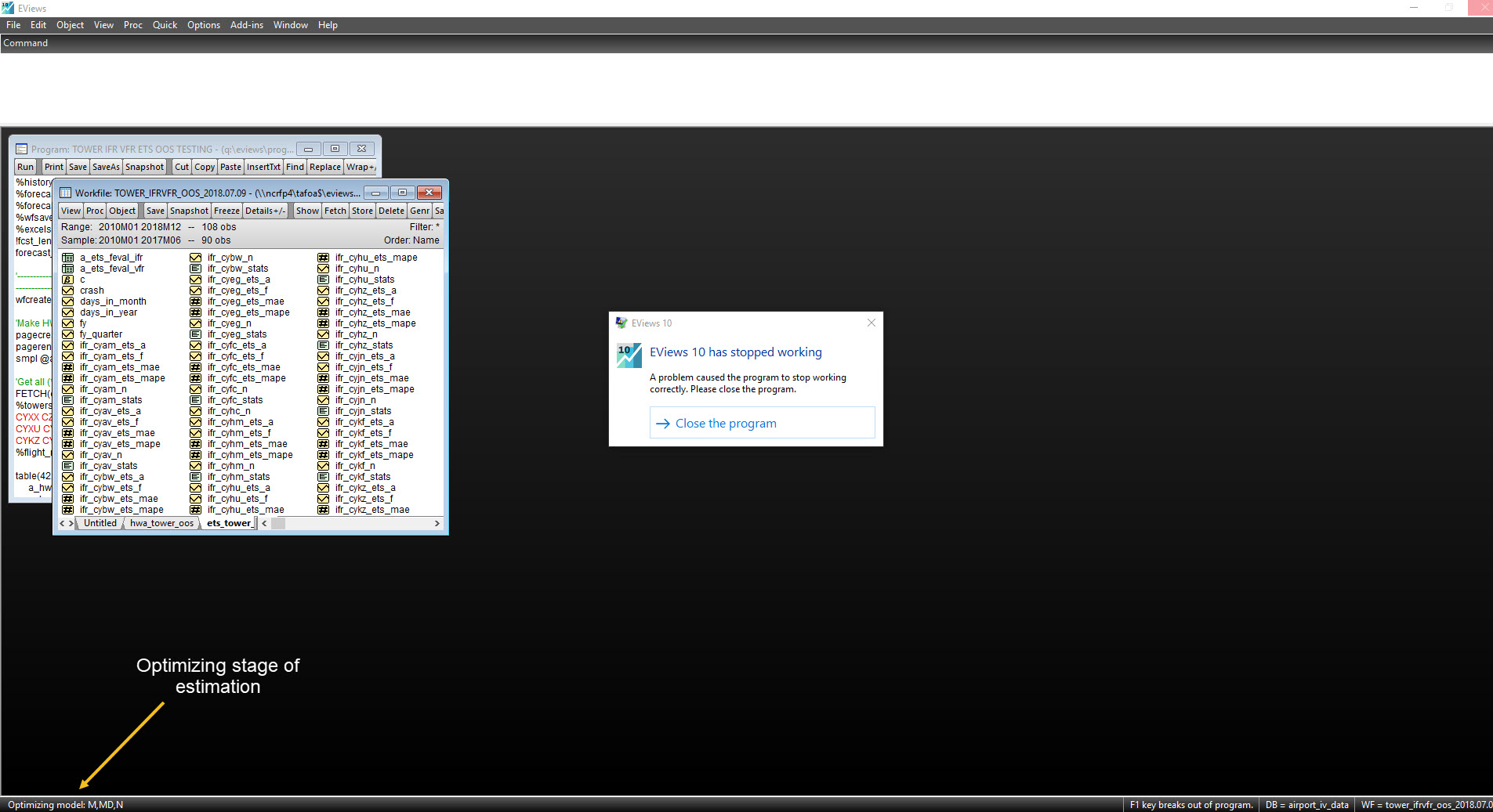

I think it could be more of a general problem, since it still occurs if I drop CYHC. In the bottom left of the screen it is at the Optimizing Model stage.
Hate to ask, but will the bug fix be somewhat quick as we need to get some forecasts done. See the screenshot attached.
Cheers!

The bug is that some ETS models do not converge, and then the likelihood value is NA, and the graphing code doesn't like graphing NAs. You can make a temporary fix by changing:
freeze(mode=overwrite,{%series1}_{%series2}_stats) {%series1}_{%series2}_n.ets(e=e,t=e,s=e,modsel=aic,graph=cl,table=cl) forecast
to be:
freeze(mode=overwrite,{%series1}_{%series2}_stats) {%series1}_{%series2}_n.ets(e=e,t=e,s=e,modsel=aic,graph=cl,table=cl, noconv) forecast
Or, getting rid of the graph=cl option.
