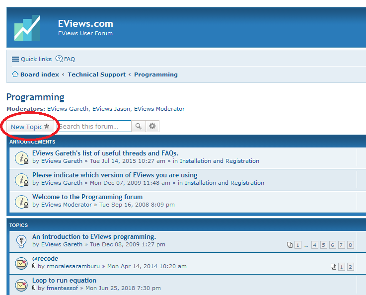

By the way, i can't find the place to post my own question, could you show me?
Best,
@recode
Re: @recode
Best,
SK :D
SK :D
EViews Matt
- Posts: 592
Re: @recode
When you're on the topic list page for a board, just press the "New Topic" button. This button is located near both the top (shown below) and bottom of the page.

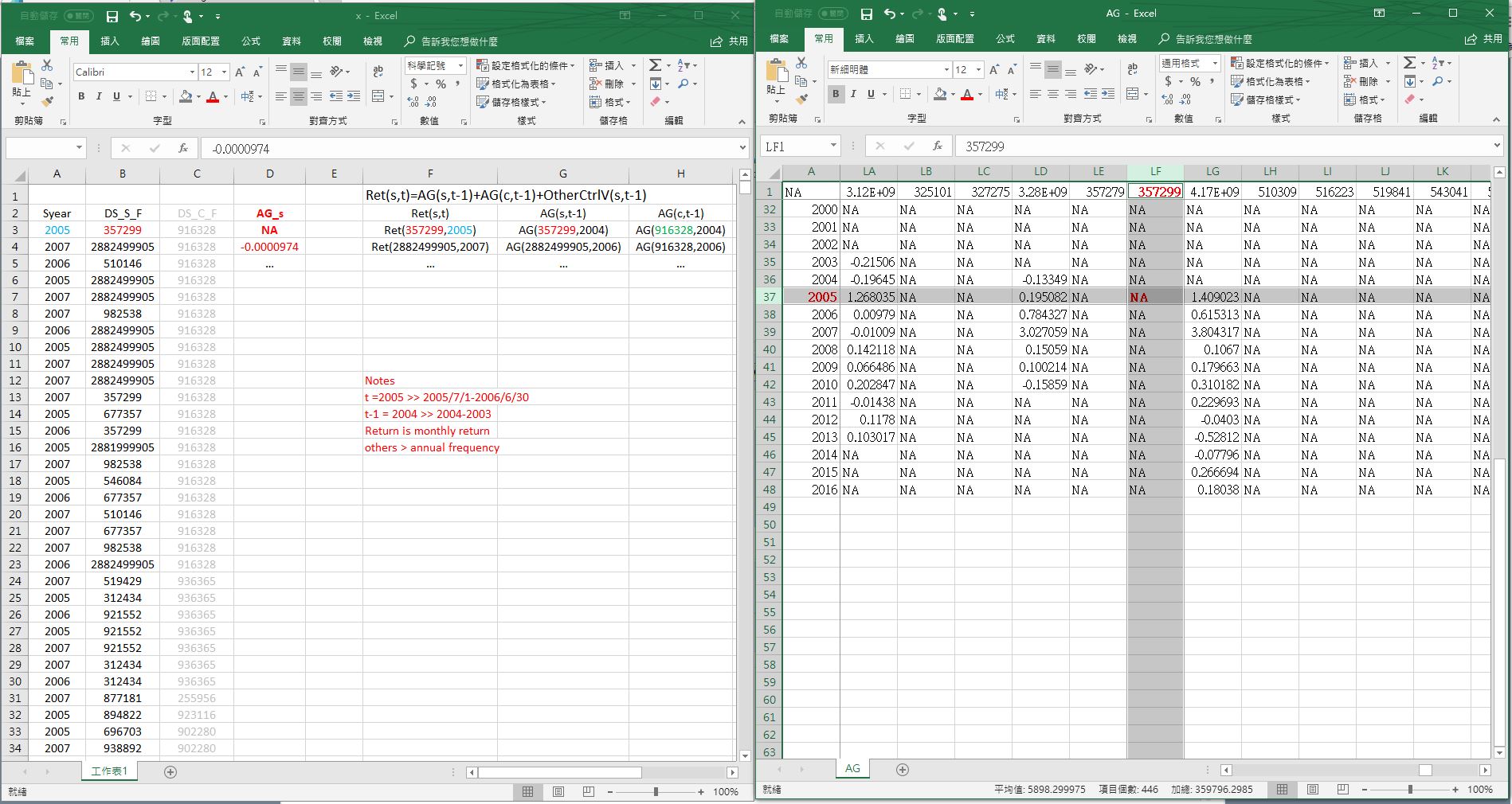

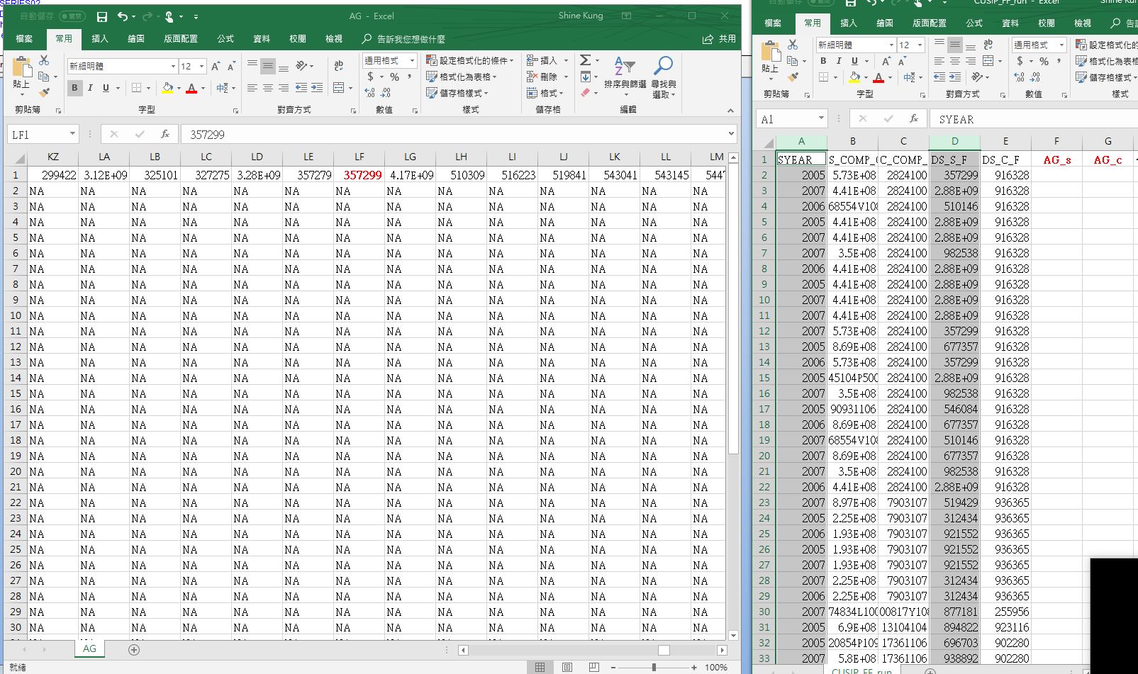

but now, I have 2 requirements, i need to comparison the 'ds_s_f' and 'syear'
for example,
if ds_s_f=357299, syear=2005 exist in file AG, then AG_s= the value in file AG
here is the code that i tried to run, but i do not know how to get the specific cell(e.g. 357299,2005)in AG
I have another problem for merging data, it's a little bit like the question i asked before, and below is the suggestion that you gave me.
for example,

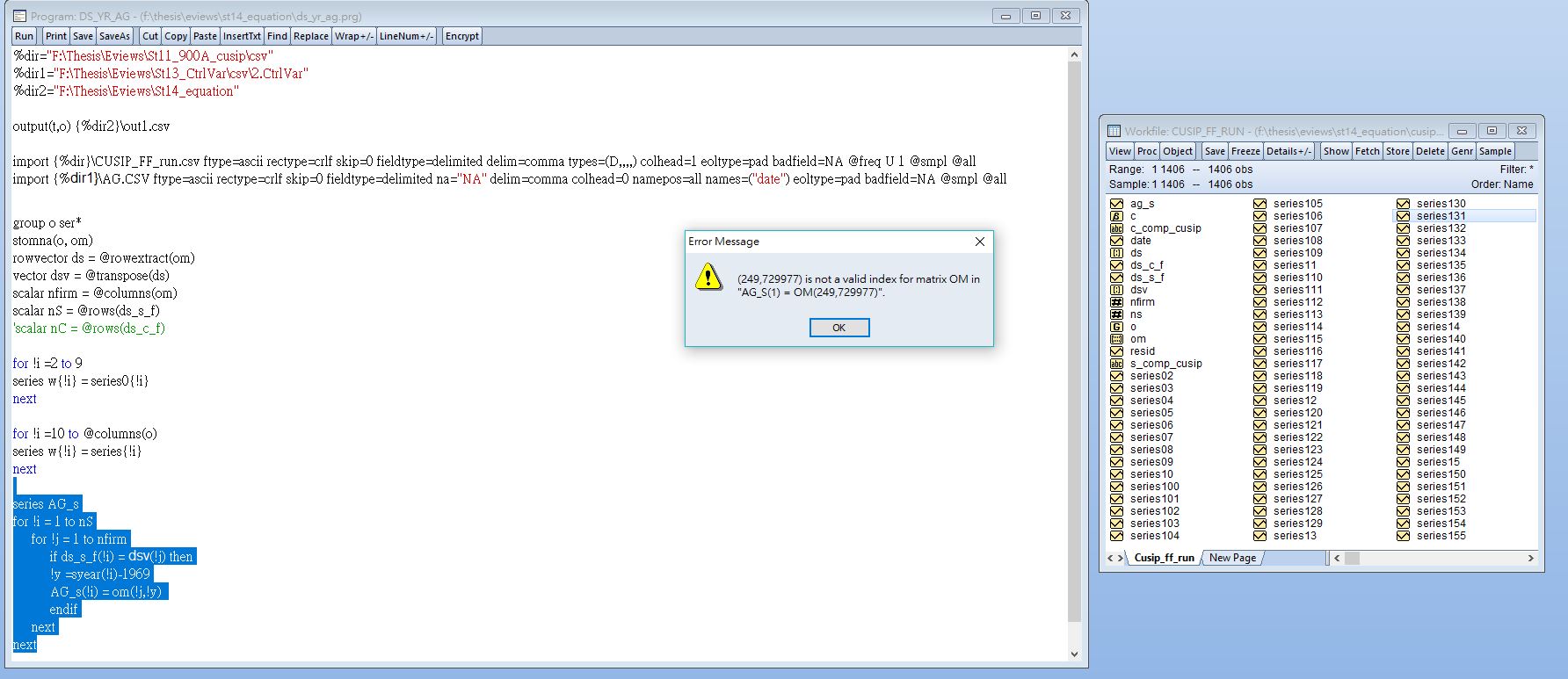

Actually, I only have a cusip_FF_run workfile, and import the AG in the same workfile(please check the attachment)
Where i stuck is that i try to find whether the ds_s_f is in the group om R1, if exist, and find the date(correspond 'syear'), then got the value or NA(as following picture)
But there may have something wrong in my loop, there always show errors(i don't know why '!y' showed that value, '!y' should be the order from header to bottom, e.g. 2005-1969 = 36, pick the no.36 value of the column)...please help to find where i need to modified, or there maybe have another much easier and faster way to solve the problem.
Thanks a lot!!!!!!!!!!!!!!!!!
