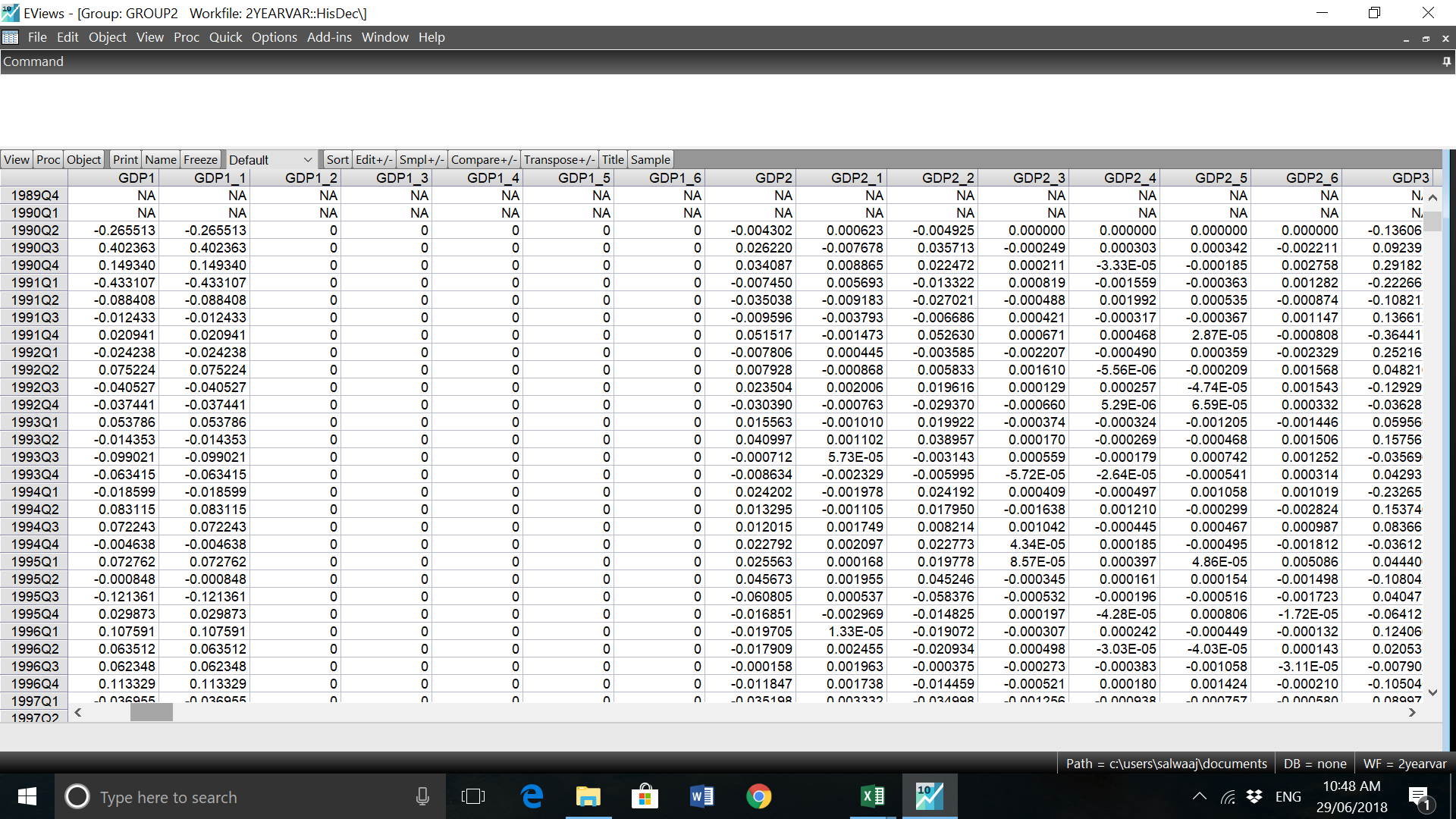

I followed your instruction, in the output box they ask for series basename and group name and it doesn't work without series basename so I put GDP but I got this result attached picture, it doesn't show the name of other variables only GDP which is the series basename!

Dear dakila, can you explain how I can read the results I got from output box in historical decomposition?
