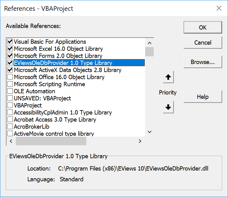

Thank you for pointing out the reference issue. In the main project there is two references, the first one is the EViews 9.0 Type Library and the second one is named EViewsOleDbProvider Type Library. I managed to remove the wrong one when making this test Sub.

You don't need to reference the "EViewsOleDbProvider 1.0 Type Library" either. You only need that if you plan on instanciating the COM object directly which you are not doing. You're just passing the connection string that mentions our object's PROGID and having the ADODB.Connection object instanciate it for you. So please remove all EViews-related references and try again.
The reason I had you call regsvr on both DLLs is because if your VBA client is 32-bit, it'll want to use our 32-bit oledb driver. If it's 64-bit, then it'll want to use our 64-bit driver. Having both versions registered from the same "EViews 10" folder means regardless of the bitness of your VBA client, you know it's using one of those two DLL files.

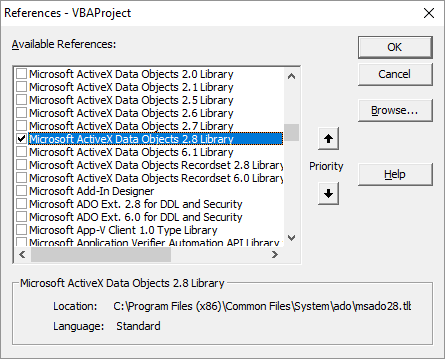

Just a thought, since our OLEDB object is being loaded by ADODB.Connection, maybe your ADODB reference is what changed? Which version are you using in your sample? My previous test was with "Microsoft ActiveX Data Objects 2.8 Library":
