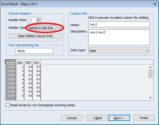

Our import wizard is usually pretty good and showing you what options are available during import. The one you're looking for is "Header type" on page 2 of the import wizard:
Then, it's a matter of correlating that option with our IMPORT documentation to find out what the exact name of the argument is for the IMPORT command. In this case, it's namepos.
