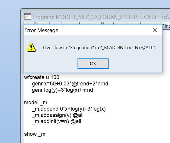

When moving our macro model from TROLL to EViews we have to make EViews understand which variable that is to be treated as endogenous in each equation. For example, if we have the equation
y = 4*x + .2*y
and x is to be treated as the endogenous variable, EViews Chris reccommended that we just rewrite the equation as
0*x + y = 4*x + .2*y
see the post http://forums.eviews.com/viewtopic.php? ... oll#p33688.
Now it seems that this advice creates some problems with respect to initializations of add factors. To see this, run the commands
Which generates the error message:
y = 4*x + .2*y
wfcreate u 100
genr x=50+0.03*@trend+2*nrnd
genr log(y)=3*log(x)+nrnd
model _m
_m.append 0*x+log(y)=3*log(x)
'_m.replace 3*log(x)=log(y)
_m.addassign(v) @all
_m.addinit(v=n) @allIf you however uncomment the line '_m.replace 3*log(x)=log(y), the addinit command works fine. This is what Dag illustrated in the example above. Is this something you can fix? If so, it would be highly appreciated.Overflow in "X equation" in "_M.ADDINIT(V=N) @ALL".

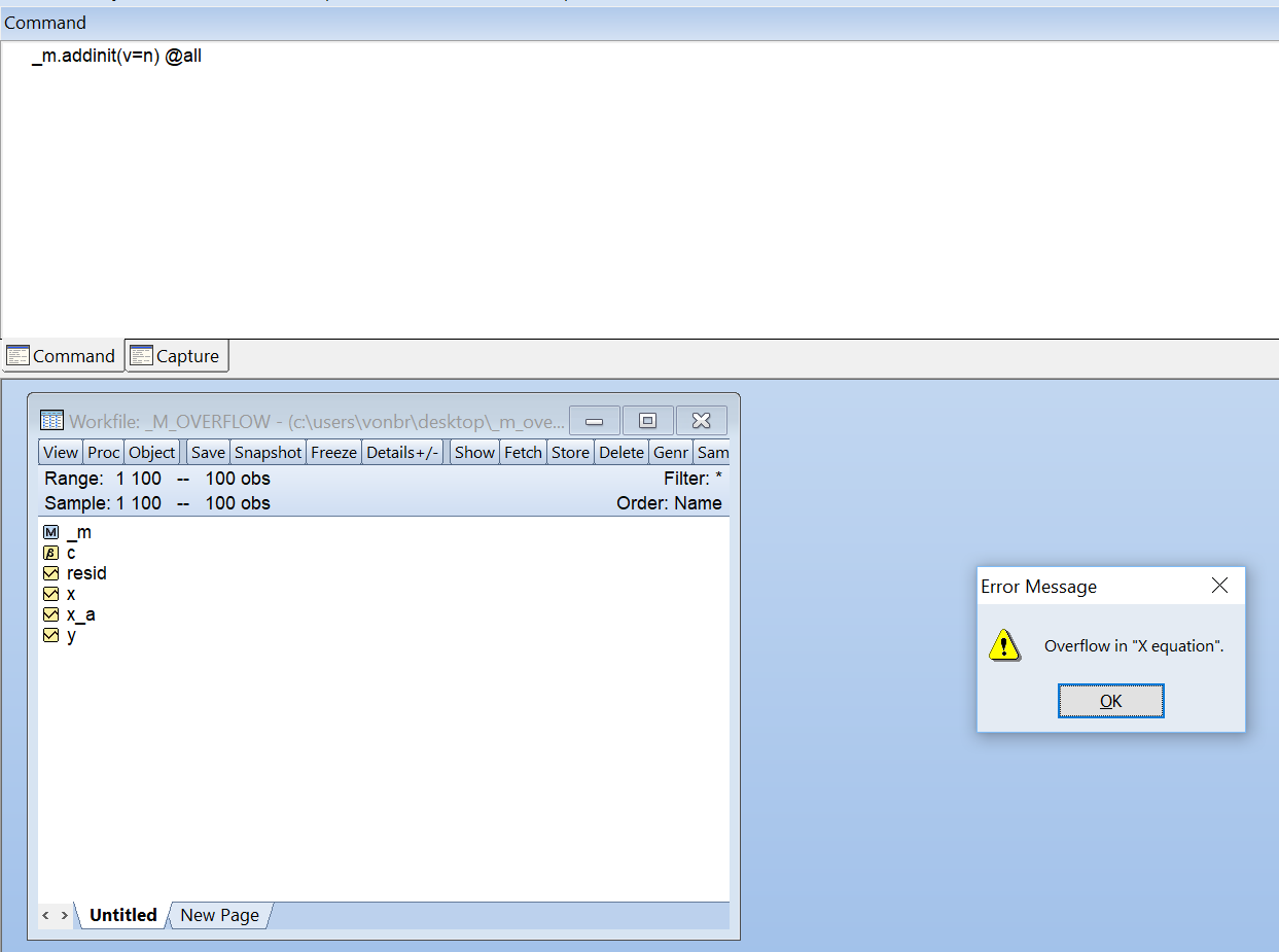

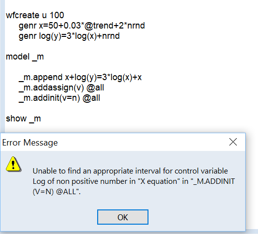

The first picture is the error I get when running the program. I get the second error when I have the model
i.e., I change y=f(x) to x+y=f(x)+x, instead of 0*x+y=f(x).
I have EViews 10, Apr 3. 2018.
It is very strange that you cannot reproduce this... I have also attached a workfile. Try to run the command and you should get the error message in the second picture.
_m.append x+log(y)=3*log(x)+xI have EViews 10, Apr 3. 2018.
_m.addinit(v=n) @allThomas
- _m.WF1
- (16.61 KiB) Downloaded 1327 times

do you get an error if you run the command
on the attached workfile? In this case the model is: 0 * x + log(y) = 3 * log(x).
When I run it, I get: Thomas

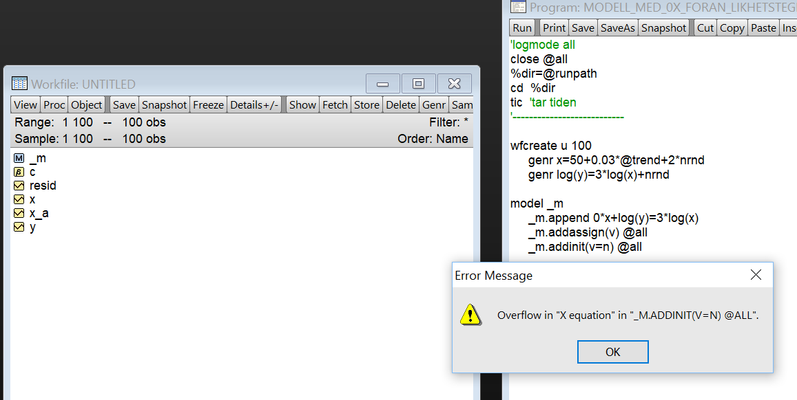

Re: Add factors
No error.
Try deleting (or moving so you can move it back) your EViews ini file.

Re: Add factors
I moved the ini file and reopened EViews (EViews then created another ini file), but EViews still reports an error when running the program......
any other ideas about what is causing this error?
T
T
