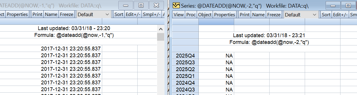

I want to create a date string for 2 quarters ago, e.g., if we are currently in 2018:1 I want to generate the string "2017:3". I tried the command
%qlag2= @datestr(@dateadd(@now ,-2,"Q"),"yyyy:q")
However, it does not work, see
How can I do this in another way?

I did not do anything with it. It works now, since we are in the beginning april. However, when I generated the series (on March 31st) it did not work. I think it is related to the posts: http://forums.eviews.com/viewtopic.php? ... add#p60254 and http://forums.eviews.com/viewtopic.php? ... add#p49282.
How can i get around this? Is there another way of generating the string %qlag2 in a way that is stable and that will always work?

Ah, I'm an idiot for not seeing it before.
If you do:
@dateadd(@now, -2, "Q")
on March 31st, EViews will minus 2 quarters (6 months) from 31st March. 31st March minus 6 months is 31st September, but that date doesn't exist, so it returns NA.
This is safer, and should always work:
@dateadd(@datefloor(@now, "Q"), -2, "Q")
