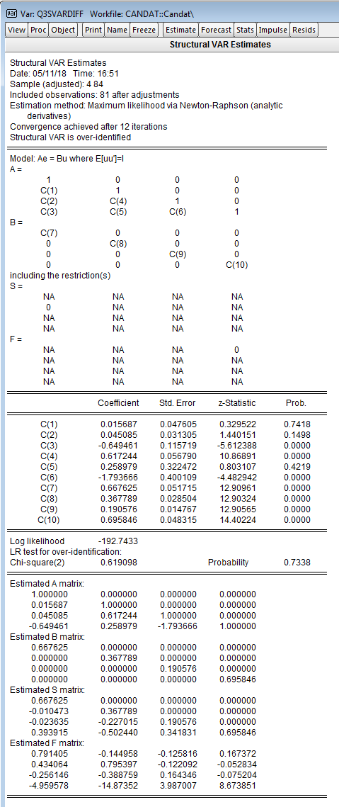

I am having an issue with a very similar topic. Eviews does not appear to be implementing my restrictions on the long-run F matrix, or S matrix. I have tried specifying it a number of ways (point & click and programming) and it still does not work.
That is, the restrictions are stated at the top of the output as I intended. But when I look at the estimated S and F matrices at the bottom of the output, my restrictions have not been implemented. Instead S is always lower triangular and F always has estimates for all elements.
Any advice would be grand.
Eviews 10 Enterprise Edition build 27 July 2017
-Alex
-Alex

Thanks for the reply.
As I am using a build provided by my university, it may be difficult to get them to update it.
The workfile is attached, along with a screen shot of the output.
The code is below.
The code is below.
var q3svardiff.ls 1 2 dprod de du ec
matrix(4,4) a_chol
a_chol.fill 1, NA, NA, NA, 0, 1, NA, NA, 0, 0, 1, NA, 0, 0, 0, 1
matrix(4,4) b_chol
b_chol.fill NA, 0, 0, 0, 0, NA, 0, 0, 0, 0, NA, 0, 0, 0, 0, NA
matrix(4,4) fmat
fmat.fill NA, NA, NA, NA, NA, NA, NA, NA, NA, NA, NA, NA, 0, NA, NA, NA
matrix(4,4) smat
smat.fill NA, 0, NA, NA, NA, NA, NA, NA, NA, NA, NA, NA, NA, NA, NA, NA
q3svardiff.svar(s=smat,f=fmat,a=a_chol,b=b_chol) - Attachments
- lrres.png (41.74 KiB) Viewed 22865 times
- lrtest.wf1
- (53.74 KiB) Downloaded 862 times

That S is lower triangular is a consequence of A being lower triangular and B being diagonal (remember that S = A^-1 * B). As I suspected, running your SVAR with an up-to-date version of EViews generates an error indicating that the optimization converged before the S/F restrictions were satisfied. Re-estimating with different initial values multiple times produces the same (bad) results, which hints that the restrictions may be misspecified. I then took a look at the analytical consequences of your restrictions:
- S(2,1) = -A(2,1) * B(1,1) = -C(1) * C(7) = 0. Clearly, this is only satisfied if C(1) = 0 (under the assumption that the diagonal of B cannot contain zeros). This is likely problematic since the model is already over-specified and these extra restrictions don't match the behavior of the data.
- F(1,4) = Psi(1,4) * B(4,4) = Psi(1,4) * C(10) = 0. Unless Psi(1,4), which is based on the underlying VAR estimates, happens to be zero, this restriction is impossible to satisfy (again under the assumption that the diagonal of B cannot contain zeros).

Re: Long run restrictions for a structural VAR
Fantastic, thanks for the help.
I will go over my identification restrictions more thoroughly and hopefully get some traction on it.
Still very useful to know that my build behaves in this way.
-Alex
-Alex
