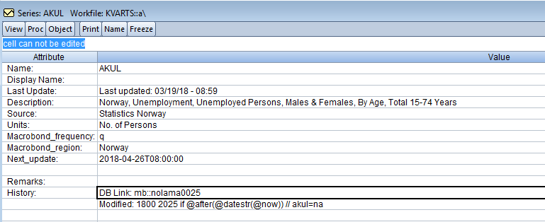

How can I fetch the "History" information about a series?
For example, for the series
how can I retrieve the information "DB Link: mb::nolama0025" using code? I was hoping that something like this would work....
series.@history

series.@attr("history")

great, thanks
