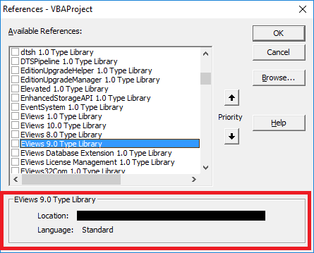

One way to tell if your EViews type library reference is available is to go to your VBA window and select Tools/References, then scroll down to reference and select it. Below it, you should see the Location label that tells you where that reference originates from. Verify that the path still exists on your machine. Also, our latest COM whitepaper describes EViews version issues on page 9 starting with the sub-heading "Choosing an EViews Version". Reading this may be helpful.
