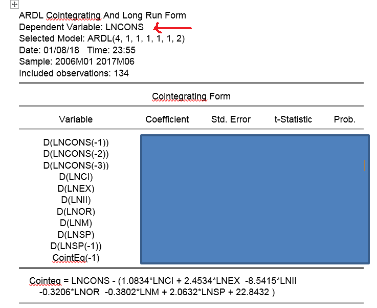

I generated an ardl Model using Eviews 9. If I'm right, the attached picyture is the error correction representation of ARDL model (which is obtained by clicking the Long run and cointegrating form after it passed the bound test). The red arrow pointed to the dependent variables, why it is not first differenced, i.e. d(lncons) since this is an ECM?
In my analysis, I should write the short run equation as d(lncons)= ......., is that right?? but why is the output show no difference?

Postby EViews Gareth » Tue Jan 09, 2018 9:15 am
That output displays the dependent variable from the original regression, not the current ECM view. I think we changed this in 10 since it did lead to confusion.
