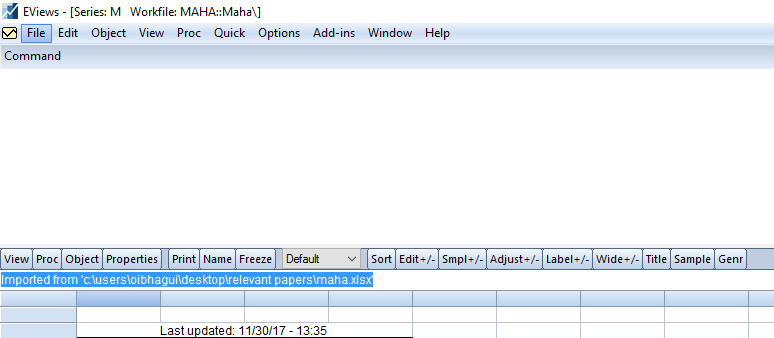

Hello Gareth,
Thank you for your quick response.
I have been looking for this ''Range'' word, not sure why I could not find it.
Please find attached the options on my workfile. Please where can I get this ''Range''?
I look forward to hearing from you.
Regards
Posts: 13604
Re: Help with ARIMA Fissues

Postby omo_laws » Fri Dec 01, 2017 4:14 pm
Many thanks Gareth. Issues resolved.
