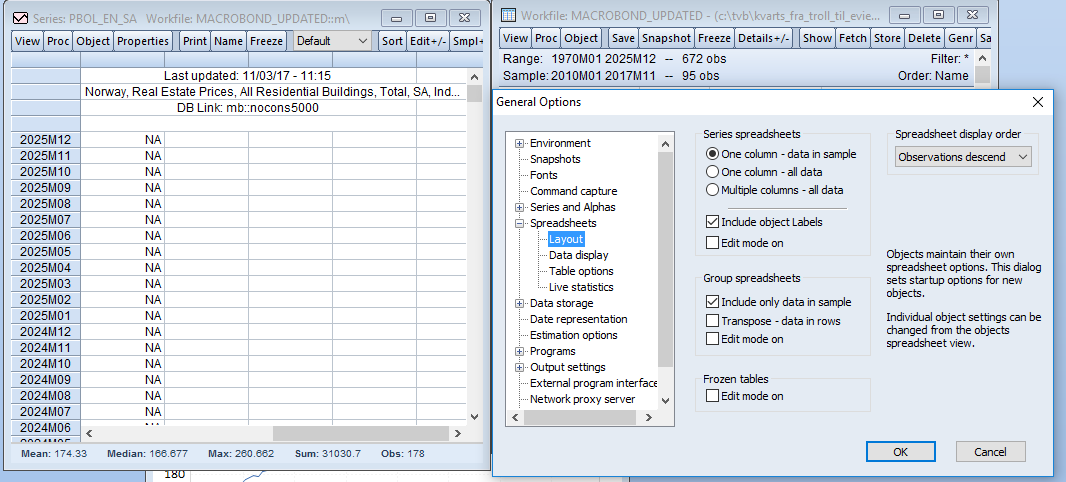

Postby tvonbrasch » Sun Nov 19, 2017 7:06 am
how can I make it so that a series, when using the commands
smpl 2015 2017 show pbol_en_sa
only will show the values between 2015 and 2017? I tried changing the options menu, but it does not work....
Re: Smpl - series
Postby EViews Jason » Mon Nov 20, 2017 11:19 am
The settings in the global options dialog determine how new series are opened.
If you already have a preexisting series use the SMPL+/- button in the series button bar. This will toggle the view to use/not use the sample.
