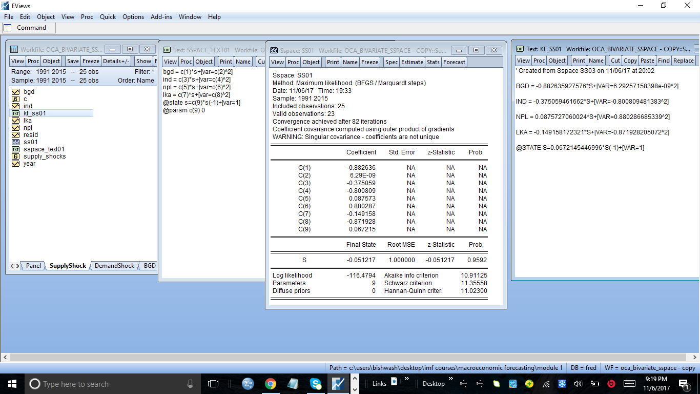

Following Chemie, DeSerres and Lalonde (1994), state-space model is used to decompose structural shocks into unobserved common and country specific components to estimate symmetries of shocks across the countries in the region. The screen shot attached herewith shows the results of the following state space model for supply shocks:
bgd = c(1)*s+[var=c(2)^2]
ind = c(3)*s+[var=c(4)^2]
npl = c(5)*s+[var=c(6)^2]
lka = c(7)*s+[var=c(8)^2]
@state s=c(9)*s(-1)+[var=1]
@param c(9) 0
As you can see, the results do not show standard errors, z-statistics and probability corresponding to each coefficient. It seems that the above state space model is incorrectly defined. Please advise.
