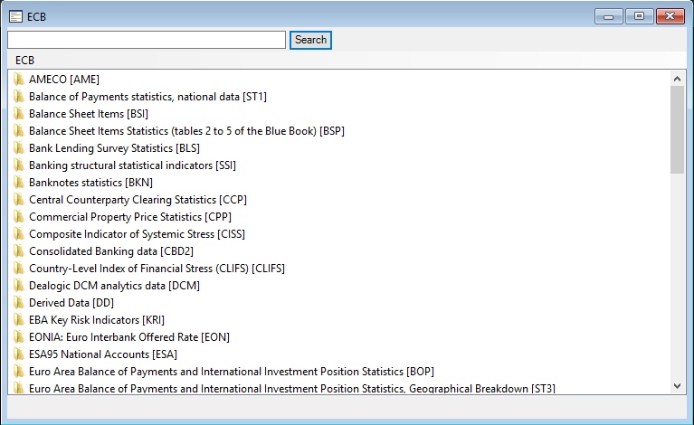

Second, I'd like to address your statement about retrieving data from the ECB. The ECB EDX interface from within EViews is different. When we created it, we had in a mind a user that wanted to discover what was available from the ECB as they navigated thru it. Hence, when you first click the Browse button you see a readable list of available datasets:

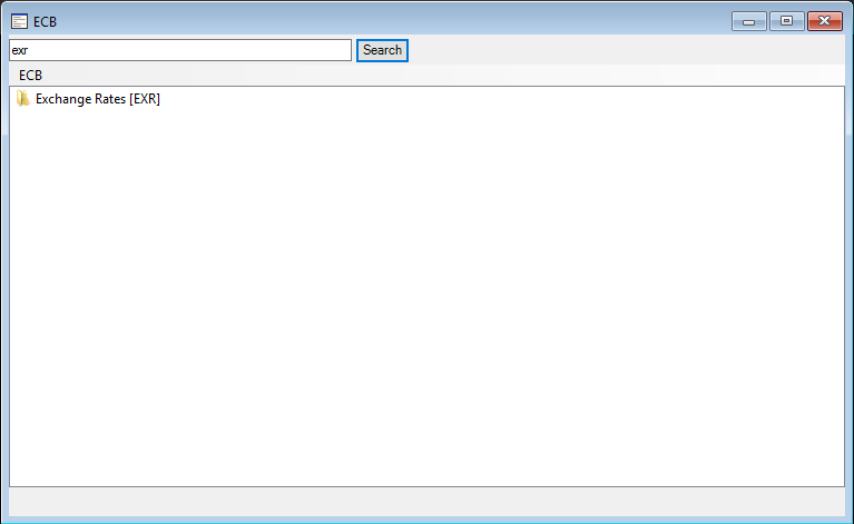

If you notice in your first ECB object name above ("EXR.D.AUD.EUR.SP00.A"), the first part of that name specifies the ECB database. In our case, if you type in EXR into the search textbox and hit Search, you'll see the corresponding database name (Exchange Rates):

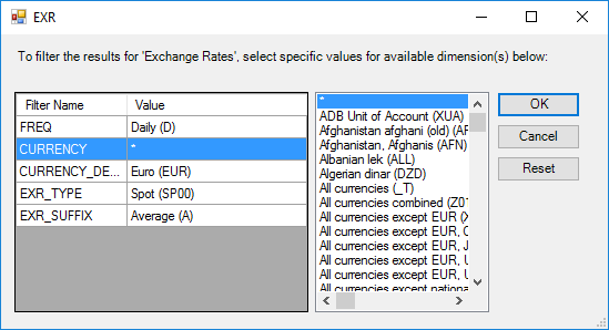

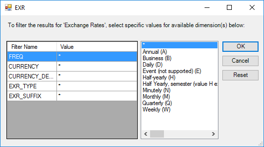

If you click that database node, you'll see a dialog that shows the available filters:
Each row of filters corresponds to an element in your object name - in fact, the element lines up exactly as we are displaying these elements as the ECB defines them.
So to match EXR.D.AUD.EUR.SP00.A, you would pick Freq=Daily, Currency=AUD, Currency_Denomination=EUR, EXR_Type=Spot (SP00), and EXR_Suffix=Average (A). To see a list of all of the ones you mentioned above, you would make Currency=* or Currency=AUD,CAD,CFH,etc. (this filter lets you pick multiple items from the list).

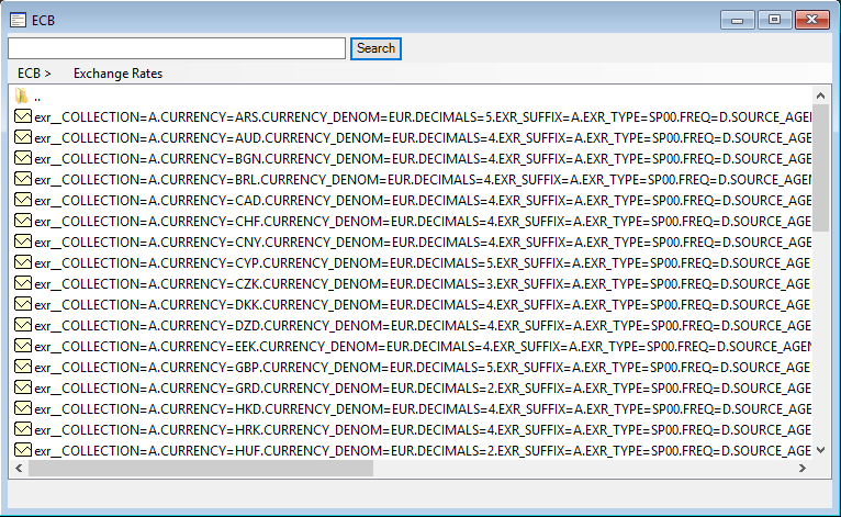

Once selected, if you click OK, you'll see a list like this:
You can now select these objects to make them appear back into the EViews Database window for ECB. Once there, you can drag them to a workfile or export them to a new workfile to see the data.
