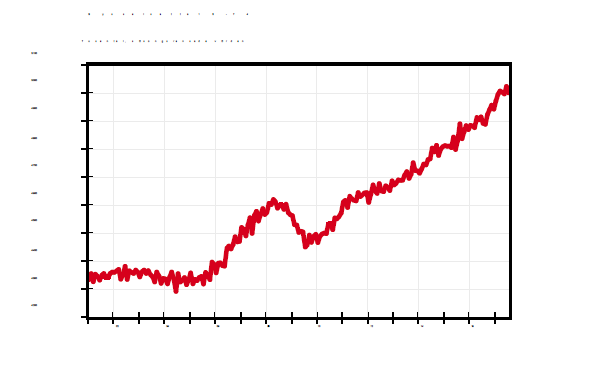

Postby nilslh » Tue Sep 12, 2017 4:16 am
I figured out a way around the problem by grouping the figures and then merging before assigning them to a spool object. However, the (merged) figures are right aligned in the rtf when I would like them to be centered. When exporting to a pdf the figures look very nice except that all the titles, axes etc. are printed in very, very small letters... When I look at the spool in Eviews it looks fine. Does anyone know a solution to this problem?
