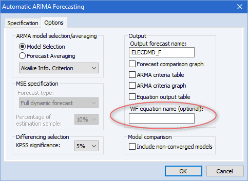

Once I've selected the best model how do I get that equation? I know how to construct the interval once I have the SE. Thank you so much for your help.
Posts: 13608
Re: Forecasting Intervals for ARIMA and Holt Winters
Postby EViews Gareth » Mon Aug 28, 2017 12:02 pm
