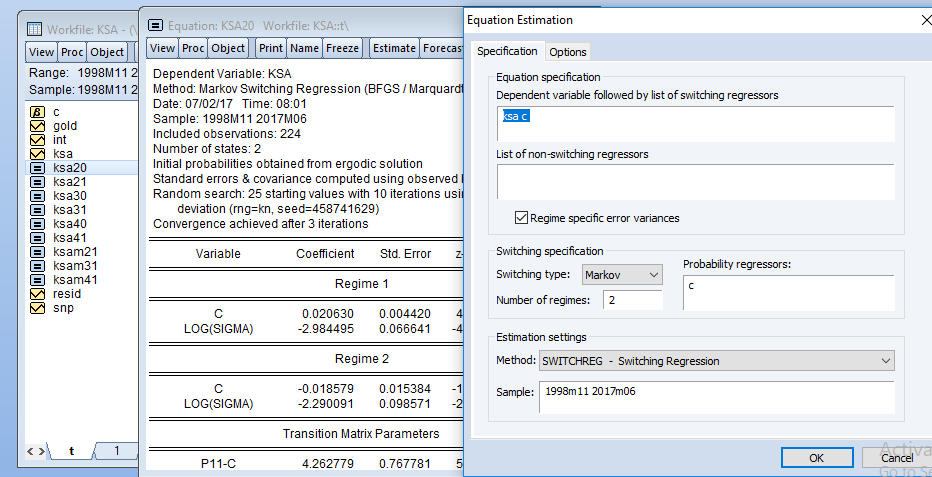

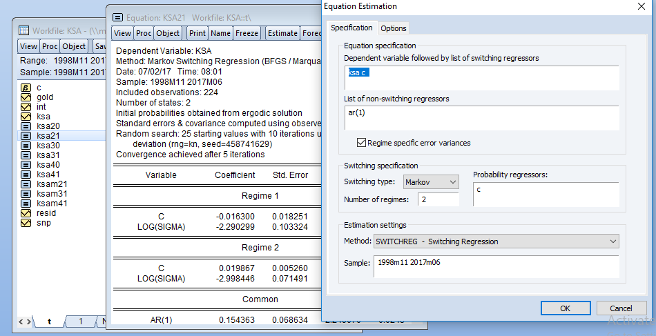

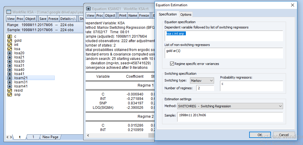

I am following a study that is very much similar to https://doi.org/10.1016/j.pacfin.2013.12.003 and is required to conduct a univariate and multivariate Markov regime switching estimations. I have attached a screenshot of parameters I've set while estimating and haven't tinkered with the option tab. The Independent variables used are the same as of the journal mentioned above. The dependent variable is percentile return on stock market of 6 GCC countries. {In picture, KSA (Ticker: TASI).}

- Parameters set for Univariate Non-AR estimation
- Univariate Non AR .png (88.21 KiB) Viewed 4768 times
- Parameters set for Univariate estimation
- Univariate .png (93.64 KiB) Viewed 4768 times
- Parameters set for Multivariate estimation
- MultiVariate.png (103.15 KiB) Viewed 4768 times

The coefficients of the model are available in the usual way as an @coefs data member off of the estimated equation.
The only classification measures we report at the regime probabilities, which you can use in various ways to compute various RCMs. The tests to which you refer are not built-in, nor is the Cho-White test.
The singularities you report are common with MS models. One often has to play around with starting values, but even so, some models are not be easily estimable.
