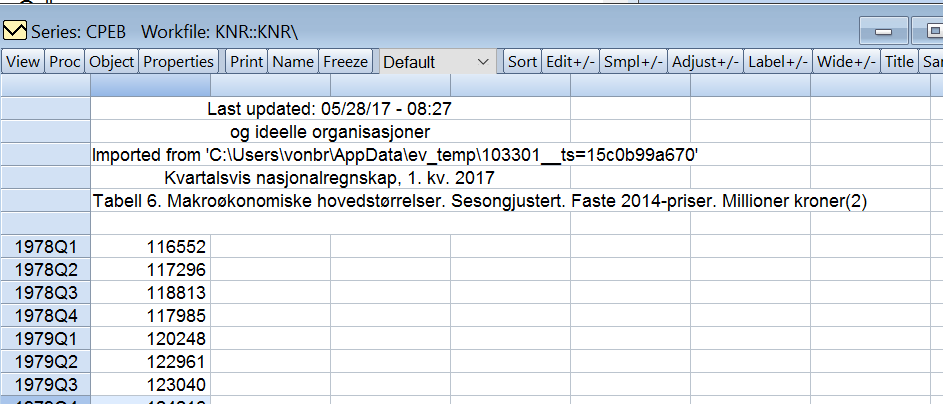

If I have a series with labels, say
How do I delete a particular label row?
For example, how do I delete: "Imported from 'C:\Users\vonbr\AppData\ev_temp\103301__ts=15c0b99a670'"
so that the series label becomes:
og ideelle organisasjoner Kvartalsvis nasjonalregnskap, 1. kv. 2017 Tabell 6. Makroøkonomiske hovedstørrelser. Sesongjustert. Faste 2014-priser. Millioner kroner(2)

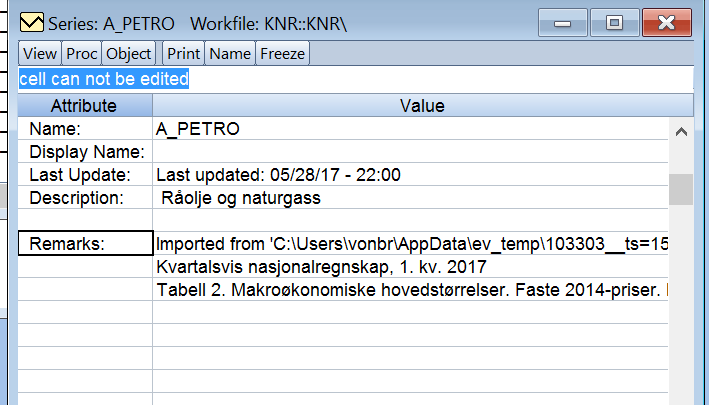

When you click on View->Label, which label is it?
Re: deleting part of series label
Postby tvonbrasch » Sun May 28, 2017 1:01 pm
It is a remark
Postby EViews Gareth » Sun May 28, 2017 2:26 pm
Well interactively, you can just delete them whilst in that view.
Programmatically it is a little more tricky. You can use series.clearremarks to wipe all remarks out.
If you wan to keep some, you'd have first retrieve all the remarks with %a = series.@remarks. Then parse it and remove the ones you want, then set the remainder back as remarks using series.setattr("remarks")
