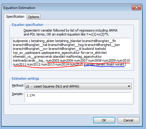

Estimate equation - Least squares
- Posts: 3798
Re: (New to Eviews) Error with OLS
You know what you did and think the details are obvious. They aren't.
Tell us what the dependent and independent variables are. Perhaps a screen shot of the command you used.

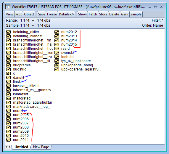

Okay sorry about that. I have now attached a screenshot of the variables that we have, as well as a screenshot of the equation window.
I have highlighted the categories (consisting of multiple variables) that are causing the errors.
What's strange is that all the variables starting with "branschtillhorighet" are the same way: dummy variables for which only one of the variables is given value "1" for each observation, with the difference that they actually work, i.e. does not render the error.
Is that more clear?
Thanks again
Is that more clear?
Thanks again
- uppsats 1.PNG (21.11 KiB) Viewed 9357 times
- Uppsats.PNG (29.44 KiB) Viewed 9357 times
- Posts: 3798
The numXXXX variables add to 1.0. So do the country variables. So each set is perfectly multicollinear with the intercept, c. Drop one of numXXX and one country variable and you should be fine.
