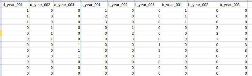

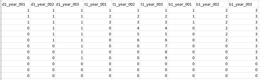

Postby ecofin » Sat Apr 08, 2017 2:47 am
All previous programs generate dummy equal 1 and rename it by different way as required "d_{same date}" for each frequency ( day, month, week, interday, or by spanning by two month, two weeks...), how can generate and rename defferent trend "t_{same date}" "b_{same date}" in same time with the series dummy by the previous code (the same logic of previous programs) . below you find an example that what i need.

EViews Matt
Posts: 592
Re: rename dummy and diagonal dummy
Postby EViews Matt » Mon Apr 10, 2017 9:00 am
I see. You can generate both types of trends with fairly simple @recode statements. For example,
series t_003 = @recode(d_003, @nan(t_003(-1), 0) + 1, 0) series b_003 = @recode(d_003, 3, 0)
The same idea should work for both the cumulative and non-cumulative dummies (d1_* and d_*).
