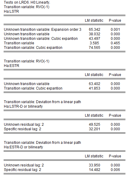

Thank you this is very helpful. I have a hunch that my data is well suited to TAR model, but I need to fit the STAR model to compare and be sure. The histogram you see is for the first time series. I am now trying to build the STAR model for the second time series, but I am getting the errors I showed.
I will try the random numbers for starting values.

Dear Nicolas,
I believe I have corrected the problems I was having yesterday, which is shown in the above post. No matter which starting values I chose, and how I changed the convergence parameter, I just couldn't get reasonable results. I was having failure to converge which resulted in unreasonably large standard errors and p-values of exactly equal to 1.
So I believe it was due to the transition variable being in log-diff form. I had taken dlog(rvo) of my transition variable to ensure stationarity, but as it turns out, my transition variable is already stationary in level form under multiple tests for unit root. So when my transition variable is in levels, the model converge and a I get more reasonable results.
However this lead me to a new question about the tests for Linearity you describe in section 2.1 of the documentation. The transition variable fails to reject the null of linearity with p-value of 0.465. But the cubic expansion of the transition variable strongly reject the null of linearity. I'm confused by these contradictory results. Does this contradiction indicate problem with my choice of transition variable?

The final test that one should always do is to compare the linear model with the nonlinear in terms of adjustment, if the nonlinear one gives you better results you should keep it.
Regarding the stationarity of the transition variable, since you apply a funcion which codomine is bounded the resulting variable will tend to return to their mean, so I guess that the evaluated funcion will be a second order stationary variable, I'am not sure about this if I find something about it i will tell you.

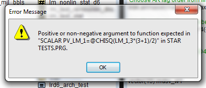

I am getting an error message these days when I try to run the STAR package. This just recently started. I cannot figure out why this problem is occurring, as the package was working fine just yesterday.
It is because the LM_1 statistical is negative, It has never happened to me. Could you post your workfile and your code to replicate the error?
Regards,
Hi Nicolas, sorry for the delay in my reply. I'm not quite sure what was causing this error. I basically wiped my workfile and started fresh and I have since not received that error.
Thank you for offering to help though!
