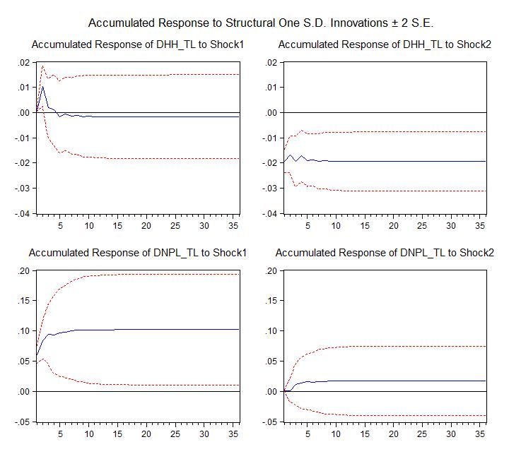

I have another question, this time relating to the impulse response. In the BQ factorization, the response of the first variable (dhh_tl) is constrained to be zero with respect to the temporary shock (shock 2). But in the impulses, we find that dhh_tl is responding to shock2 significantly. Is there something wrong in the program.
Velasquez
