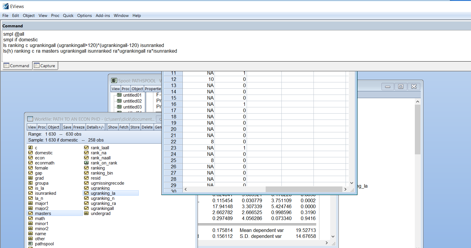

Take a look at the picture. I opened a new group window. Here's a picture of where EViews opened it. I haven't moved anything. A window shouldn't open with the title bar hidden under the command window.

Is your command pane set to Autohide? Since your screenshot doesn't show the right pin icon of the command pane I can't tell. If so that's why the group window could appear there.
If not, is the window issue reproducible?

Actually now that I've taken a closer look at your command pane, it looks like it's in Float mode. Meaning you've undocked the pane and instead told the window to hover at that spot. If you grab the main EViews frame window and move it, the command window will stay put. You'll have to dock the command window or move it outside of EViews to prevent this overlap problem.

When a window is floating, that means it's outside of the EViews frame window. And when it's outside, EViews doesn't consider it when it decides on placement of any child windows inside the main frame window, even if that window is floating on top of EViews. Also, our floating windows always appear on top of the main frame window, even if you click back into the frame area and move it around.
So technically, you could cover the entire main frame window with a floating command pane. In that case, it doesn't matter where a new child window appears since it'll never be viewable until the command pane is moved away or sized smaller.
Maybe we should consider letting you click in main frame window to bring it up above any floating panes? But then you could potentially lose sight of the command pane altogether as it drops behind.
Is there a reason why you don't have the command pane docked to the frame? When docked, it's inside the frame window and new child windows will appear away from it. Click the Window menu/Reset Window Layout to reset your windows to this default layout.
