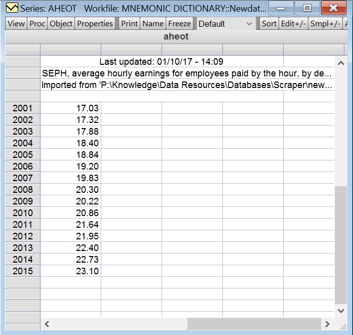

The series will have a date and value (see attachment) and I am going to find the percentage difference between one series and another one using @elem.
But, I only want to find the percentage difference for the last 10 or so values in both series. For example, find the percentage difference for the years 2005 - 2015 for both series where they both start at 2001.
- A series.PNG (38 KiB) Viewed 5898 times
