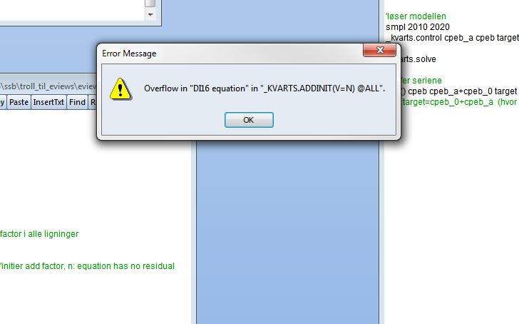

I am trying to initialise add factors so that all equations in the model have no residual when evaluated at actuals:
smpl @all _kvarts.addassign(i) @all smpl 2016 2020 _kvarts.addinit(v=n) @all
but this yields the following error message:
Is there something I am doing wrong?
THomas
addfactors.prg
(380 Bytes) Downloaded 914 times

EViews just can't create the add-factors, you're doing every thing correctly.
I would guess it might be a data scaling issue - you might need to rescale the data.

Hi Gareth
Thanks for your reply.
Can you provide me with a clue on how to proceed?
I cannot just divide variables by a scalar as the intepretation of the equations would change. Would a rescaling require a re-estimation of all the equations? Or is there another way of doing this?
The model object consists currently of only text objects which makes the job of re-estimating much more time consuming.
Is re-scaling something that could be build into the optimizer in Eviews? (ideally, an Eviews user should not have to think about this issue)
Re: add factors
Postby EViews Gareth » Tue Dec 13, 2016 8:54 am
You'd have to scale the variables, reestimate the equations and then recompile the model - painful I'm afraid.

I have a similar issue I am hoping someone could help me with.
I assign and initialize my add factors as a variable shift add factor. See below. Everything seems to work out fine when I run my program.
smpl @all
_model.addassign(v) @all
smpl 2016 2020
_model.addinit(v=n) @all
However, when I decide to assign my add factors as an intercept shift, for some of my variables (not all), i too get an overflow message. How is it that I can solve for one type (variable shift) but not another (intercept shift) which I would think would be easier. Is there a possible solution to this issue. I dread to undertake the painful approach offered below. :(
