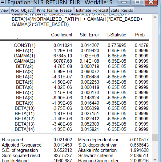

I suspect that the error results from my code rather from the data.. The estimation result look like follow
Can anyone give me a hint? Thanks!

Postby startz » Tue Nov 08, 2016 3:32 pm
I hit estimate again on NLS_RETURN_EUR and it converged. You might just want to try it manually a few times.

Postby Gin » Tue Nov 08, 2016 4:02 pm
Hi startz,
thanks for taking a look at my workfile. I still can not get a reasonable result. It always says that convergence is not achieved after 500 (or more iterations). Do you think I need to specify starting values in this case?

Postby startz » Wed Nov 09, 2016 6:44 am
It's always a good idea to specify starting values.
