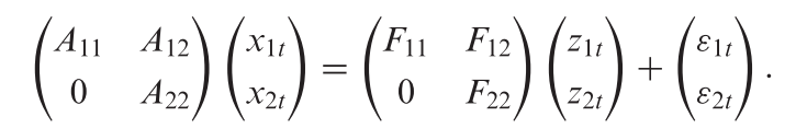

Hi everyone,
I'm trying to run an SVAR with an imposed block exogeneity restriction in the sense of Cushman and Zha (1997). My advisor tells me I can't do this in eviews last time he checked. Just wanted to confirm that this indeed is the case. I was under the impression that if I had the exogeneity restrictions in my restriction matrix, then it should run properly. Attached is the block exogeneity restriction I want to include as well as my system of contemporaneous equations for my restrictions matrix.
Any thoughts/comments are appreciated!
SystemofContempVariables.pdf
(86.91 KiB) Downloaded 440 times
Screen Shot 2016-10-25 at 3.11.51 PM.png (24.86 KiB) Viewed 3391 times

Are the e_t:s in the PDF the reduced-form residuals and should it be e_t=A*epsilon_t? Are the z_t:s exogenous variables?
