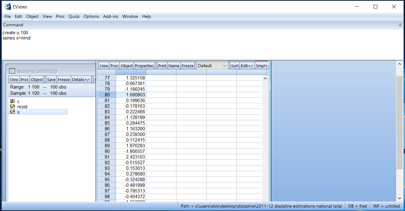

EViews has real windowing problems when used on a laptop sized screen. Here's a picture.
Note two things that are wrong.
First, the series is 100 long. But the last observation is hidden and so is the handle on the series window scroll bar. There doesn't appear to be any way to get to the last observation. (I recognize you can use the master window scroll bar to get to the bottom of the series window, though then you can't see the top.)
Second, the title bar of the window is under the command pane. That means one can't even grab the window and easily move it around.

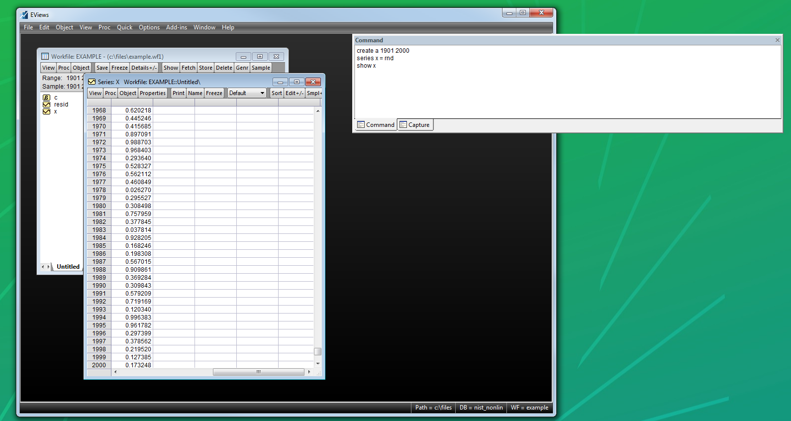

There are a few suggestions I can make:
First, you can shorten the height of the command window.
Second, you can "unpin" the command window so it pops in and out whenever you need it by un-clicking the pin icon in the top right of the command window. This will let you use more of the screen, but easily bring up the command window whenever you need it (just mouse over the command tab that should still be visible when the window is scrolled out of view).
Third, you can dock the command window somewhere else, say on the left or the right side of the screen. Since the screen is wider than tall, this could work well for what you want to do. To move the command window, make sure it's pinned (unmoving), then grab the command tab and drag it to one of the sides.
Fourth, you can "float" the command window instead of having it docked -- just grab the command tab and drag it out of the frame. You can place the floating window even outside the main EViews window if you wish.
