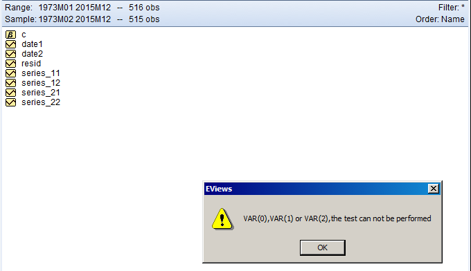

Thanks for the add-in. I occasionally get an error as attached. Any ideas why?

Re: Spectral Granger Causality Test*
Because the test is based in two linear restrictions and you can not perfom a Wald (or an F) test if the number of restriccions in greater than the number of parameters, and since you are testing if the past of one variable (all its lags) at some frequency Granger-cause another variable 2>p where p is the lag order of the VAR(p). Suggestion: try with AIC criteria.

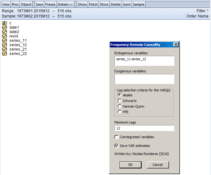

I seem to be having a similar issue with the VAR Test error message. I'm not sure what I'm doing wrong since I'm just working with a very simple case between two data series, labeled series11 and series12 in the attached temp_data.WF1 file. Both series, as well as series21 and series22, are log differences of underlying data (and as log-differences are stationary). Any help/guidance would be greatly appreciated!
Thanks!
Thanks!
You are not doing anything wrong, it is because what I mention in my previous post. You have two options, increase the maximum number lags or select the AIC criteria, in the case that any of this work ir means that a VAR(p) with p>2 it is not suggested to be fitted to the data and the test can not be performed.
