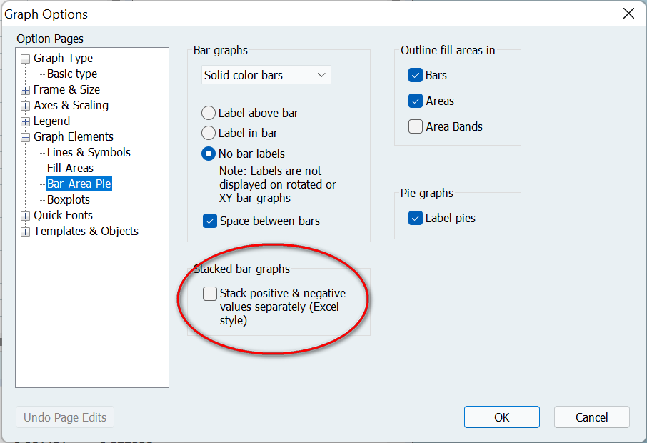

Hi, this chart type does not seem to work, when I have both negative and positive contributions in the group. The positive contributions should start from the zero horizontal axis going upwards and at the same time the negative contributions should start from the zero horizontal axis, but going in the downwards direction. But this does not seem to be the case. When I have both positive and negative ones in one period, they just stack up incorrectly, not starting from zero.
Is there a solution to this?
Many thanks.
Alexander
Posts: 13612
Re: stacked bar plus line graph
Postby EViews Gareth » Wed Feb 23, 2022 5:29 pm
alexanderk
Joined: Thu Oct 14, 2021 3:57 am
Postby alexanderk » Thu Feb 24, 2022 2:58 am
Thank you, this is very useful.
