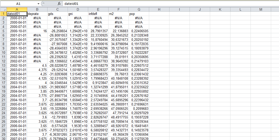

So, I converted yearly to quarterly data and the result could be seen in the first above attached file named pokusaj. When You open it, you can see how the first rows of all variables do not contain values but it says NA.
Attached is the screenshot of what I mean.
I am interested if there is any option in Eviews that i can use to get ALL the yearly data converted to quarterly, without getting these NA rows as a result, but the real numbers?

- Screenshot.png (63.03 KiB) Viewed 10137 times

You have NAs in your quarterly data. You want to convert those NAs into annual data, but magically not get NAs for the annuals?

It's not about the conversion from quarterly to annual at all, but the opposite ...
My annual data contain real numbers (as it could be seen in the above attached excel file named Yearly data). That is my source document. I converted THOSE yearly data to quarterly and got the screenshot above, with NA values. Therefore, my source data (annual) which I converted to quarterly DO NOT contain any NAs.

Sorry, misread.
I just went from yearly to quarterly and it worked just fine.

Is there any possibility for You to attach here that workfile with quarterly data You got?
I'm doing it all over again but results are the same..
