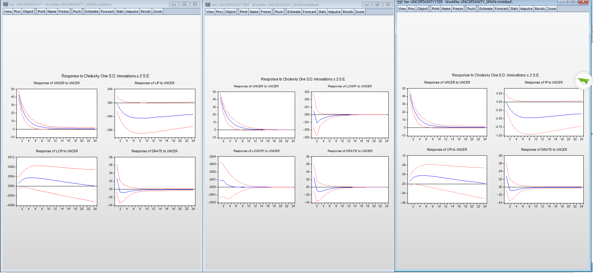

So I took a screen capture of the 3 versions of my VAR: basically it relates an uncertainty index, industrial production, inflation and interest rates.
I look at the IRF from a shock on UNCER:
In uncertainty 1, all variables are in log (except the interest rate, which always appear as a difference in levels) ; in uncertaintybis, all variables are log-differenced and in the last one, in level terms.
In uncertainty 1, it says that the impact of a 1 SD rise in uncer on LIP more or less peaks at 6 months (-0,4), whereas the impact on Logip is much more short-lived (2 months and only -0,1%) and finally the impact on IP in levels is more or less the same as on LIP but in units of industrial production, which are hard to interpret.
So basically, if I understand correctly, in the 2nd case, I can talk about % but, in terms of interpretation, do I have to say that IP will fall by at most -0,1% after 2 months and then the effect will disappear, or, do I have to say that the growth rate of IP will be 0,1% lower after 2 months ? I think the latter right?
I see the interpretation for the 3rd case but I am unsure about the 1st one. I guess in that case I can say that IP will fall by 0,1% to 0.4% each month over the 1st 8-10 months, and, if I accumulate responses, by about 9% after 24 months.
Is that right?
I promise, I will stop asking dumb questions after that ;-)
Thanks immensely for your help!
trubador
Did you use forum search?
Posts: 1520
Re: Interpreting impulse response functions: Std dev or % ?
Postby trubador » Wed Jun 22, 2016 4:17 pm
In the first case, the interpretation of the impact should be in percentages since the response variables are all in logarithms. One SD shock to UNCER leads to a 0.004 units decrease in the logarithm of LIP after 6 months, which corresponds to 0.4% drop in the LIP when translated into original level.
In the second case, however, one SD shock to UNCER leads to a 0.001 units decrease in the change in the logarithm of LIP after 4 months, which corresponds to 0.1 percentage points drop in the growth rate of LIP (e.g. from 2% to 1.9%). The only way to translate the impact into original level is to accumulate the responses, which can then be interpreted similar to the first case.
Third case is more straightforward. One SD shock to UNCER leads to 0.5 units decrease in the original level of LIP after 6 months. And that’s it.
