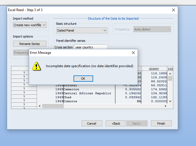

i tried that and this is what im getting.. in the attatchment
- Capture.PNG (39.18 KiB) Viewed 10050 times
- Posts: 3798
Re: Converting
Look at the picture you posted. It says the cross section identifier is year country. You want year to be the date identifier.
