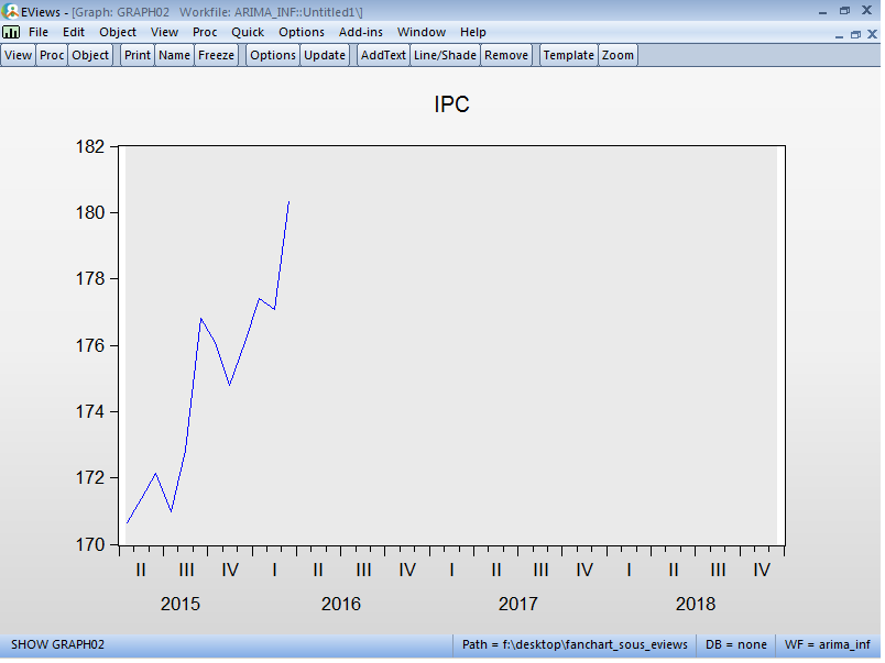

I am using draw(shade, b) to separate history from forecast in a figure. I am using these piece of commands:
range 2002m1 2018m12 %fsmpl="@first+!a @last" smpl @all !a=obs(my_variable) delete(noerr) my_graph smpl 2015m04 2018m12 freeze(my_graph) my_variable.line my_graph.draw(shade,b,gray) {%fsmpl} show my_graph
I attached a screenshot of graph I obtained after runing the code below, I named it "shade1"

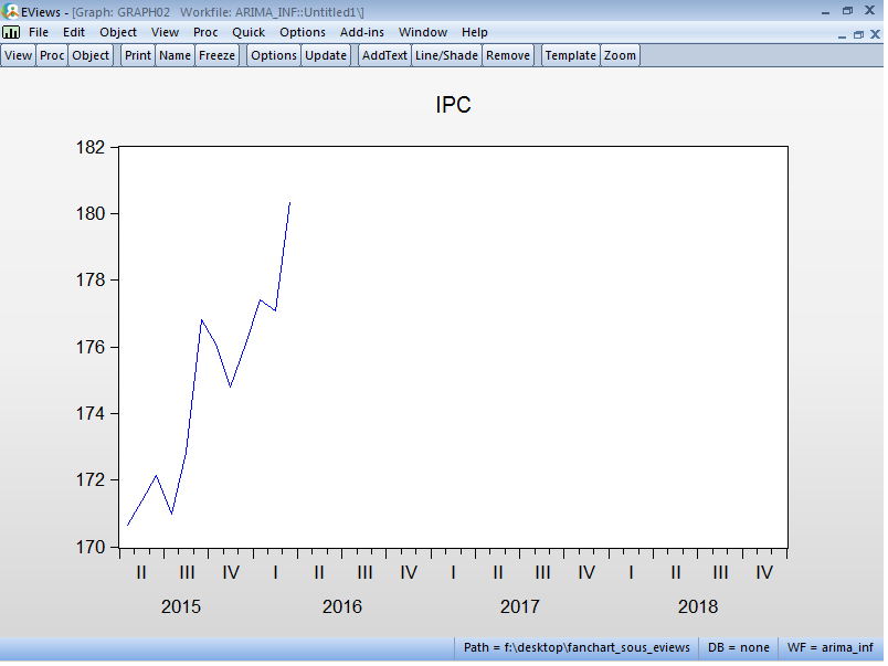

More suprinsingly, I wanted to know the value of "a" just to be sure that it's computed correcly so I runned this code (which is the same as above except for the first, the third and the fourth line):
range 2002m1 2018m12 %fsmpl="@first+a @last" smpl @all scalar a a=obs(my_variable) delete(noerr) my_graph smpl 2015m04 2018m12 freeze(my_graph) my_variable.line my_graph.draw(shade,b,gray) {%fsmpl} show my_graph
The hole graph have been shaded this time, while, in my understanding, this code should give us exactly the same result as above since I just declared "a" as a scalar instead of using it as a control variable.
I attached a screenshot of the graph I obtained this time, I named it "shade2"

.draw doesn't support arithmetic in the sample expression.

And how do you explain the difference in the results of using "a" as a scalar and as a control variable :?:
Re: shaded area doesn't appear in the graph
Postby EViews Gareth » Wed May 11, 2016 4:37 am
EViews interprets different illegal code differently.
