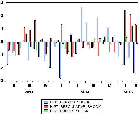

I have a question regarding the interpretation of historical decompositions in general. I am using a structural VAR model with sign restrictions and three structural shocks to model the oil price.
I estimated the historical decomposition (using sign restriction approach by uhlig) and I have used dlog(oilprice) in my VAR. Now how do I interpret the results from the decomposition?
Should shock 1 + shock 2 + shock 3 + residual shock = actual price difference? So if I am looking at the oil price decline in 2014 in specific, I should get some 60% decline with the three shocks. However, my output does not result in that difference (see attachment). Do you know how to interprete it correctly?
Historical decomposition interpretation

- historical decomposition.jpg (42.62 KiB) Viewed 12998 times
Re: Historical decomposition interpretation
Actual change = Base forecast + Shock1 + Shock2 + Shock3 + ...
And you may want to display the cumulated effect of structural shocks.

Thank you for the quick reply! I am acctually not quite sure about the exact definition of the base forecast. I assume I obtain them when drawing the historical responses of the oil price (here v4_1 ... v4_4) as I used the code below for the historical decomposition.
How would I obtain the base forecast from there?
Btw the historical decomposition looks much better with the cummulated effects - thanks!
Base forecast refers to dynamic forecasts of each endogenous variable generated from the VAR model. If you like, you can also use hdecomp add-in.

Thank you for your reply. I am not sure if my programm generates this output as it is rather long and messy... do you know where I could get some input regarding my code? That would be a great help, thank you!
It's difficult for me to follow either. But, it is quite possible that your output already includes this base forecast. If so, all you should do is to produce dynamic forecasts from your VAR model and then substract them from your output. This should leave you with the sum of impacts from shocks.
