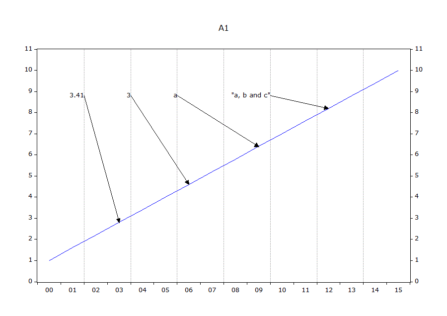

When i'm writing a label to a arrow with decimal point everything it's ok.
But when using decimal comma instead all figures after the comma-sign and the comma-sign disappear. The same phenomena if I write ordinary text with comma. I could use quotes around the text but then the quotes are visible (not so nice)
Se code and graf for example. Maybe a bug?
Regards Johan
WfCreate annual 2000 2015 Series a1 a1.adjust = 1 .. 10 Graph g.line a1 !pos1 = g.@axispos(2003,"b") !tmp = @Elem(a1,"2003") !pos2 = g.@axispos(!tmp,"l") g.addarrow pos(1,1,!pos1,!pos2) label(3.41) labelpos(horz) ' Label ok !pos3 = g.@axispos(2006,"b") !tmp = @Elem(a1,"2006") !pos4 = g.@axispos(!tmp,"l") g.addarrow pos(2,1,!pos3,!pos4) label(3,41) labelpos(horz) ' Label not ok !pos3 = g.@axispos(2009,"b") !tmp = @Elem(a1,"2009") !pos4 = g.@axispos(!tmp,"l") g.addarrow pos(3,1,!pos3,!pos4) label(a, b and c) labelpos(horz) ' Label not ok !pos3 = g.@axispos(2012,"b") !tmp = @Elem(a1,"2012") !pos4 = g.@axispos(!tmp,"l") g.addarrow pos(5,1,!pos3,!pos4) label("a, b and c") labelpos(horz) ' Label half ok Show g
