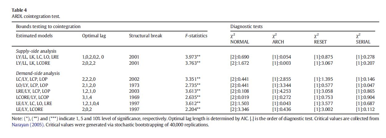

1. Having got the regression results of ARDL estimation, we can use the drop-down menu to run some diagnostic tests such as the JB normality test, BP autocorrealtion test, ARCH effect test, Ramsey misspecification test.....and associated CUSUM and CUSUM test. Please have a quick look of table 4 of Bloch et al (2015) (I attached the table4, see as below), they produced various diagnostic statistics. One simple question, are these statistics are just from those drop-down menu of ARDL estimation >>view>>residual diagnostics?

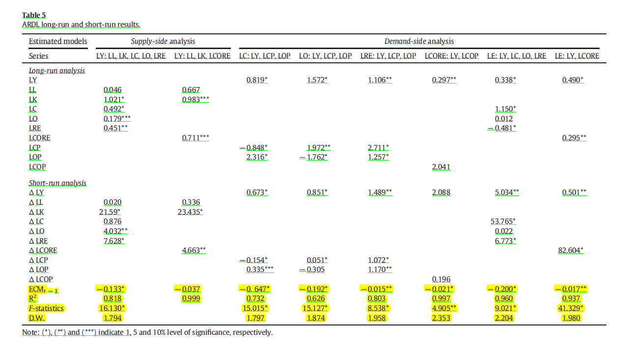

2. In table 5, Bloch et al. (2015) reported results of their long-run and short-run regression results. To the best of my knowledge, this table could be done in Eviews 9 by clicking coeficient diagnostic test>> then cointegration and long-run form (right?). However, there are no diagnostic checks provided for the long-run and short-run estimated results. How can I get them ? If I want to produce some diagnostic checks such as R-sq and adj R-sq, DW statistics etc. How can I do it manually?

- You can see R2 F-statistics and D.W test at the lower segment of the table 5
- Table 5_Bloch_.PNG (82.8 KiB) Viewed 8402 times
- As you can see, they have normality test, ARCH effect test, RESET test and SERIAL test Autocorrelation test
- Table 4_Bloch_ARDL test.PNG (69.78 KiB) Viewed 8402 times

1. That's a question that is probably better asked to the authors - we have no way of knowing what they did.
2. EViews doesn't produce those summary statistics automatically. But the longrun /cointegrating form are just auxiliary regressions that you can run manually.

1)i have download the article, probably the authors have used microfit 4 or 5 and some others software.

Forgive my poor English. Let me state my question in other way. I can perform ARDL test and then Bounds test, and then get the co-integration and long-run form (with 31 yearly observation). Similar to Bloch et al., I want to report statistics such as R-sq adj R-sq, F-statistics etc for the long-run model and short-run ECM model. Mr Gareth suggested do it manually, but how?
Can I extract estimated residuals for both the shor-run model and the long-run model? And then using them to construct summarised statistics?
For example, we use the estimated coefficients to get the predicted values for the dependent variable (say y for the long run and D(y) for the short-run).
