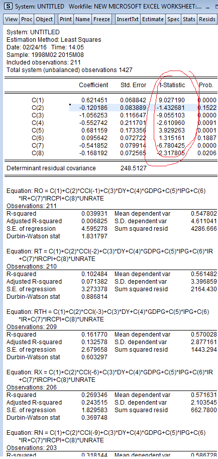

I am now testing a system of regression in Eviews and it generates several tables. The first table gives t-stat, sd, etc. as usual. However, I am not quite sure what the null hypothesis in this test.

Hi, I attached a picture and my question is the t-stat (circled). I don't quite understand the null hypothesis for the t-stat.

The coefficient is zero

so you mean the coefficients in the system are jointly zero?
Re: Equation System Estimation
Postby EViews Gareth » Wed Feb 24, 2016 1:02 pm
No.
The t-statistic on the line that starts with C(1) is testing whether C(1) is zero.
The t-statistic on the line that starts with C(2) is testing whether C(2) is zero.
The t-statistic on the line that starts with C(3) is testing whether C(3) is zero.
The t-statistic on the line that starts with C(4) is testing whether C(4) is zero.
It is a complicated system.

Thanks very much. In this sense, may I ask how I can test whether C(1)s are jointly zero in this system?

View/Coefficient diagnostics/Wald

Thanks very much for your reply. May I ask what I should type in the Wald test? I want to test whether in the system of equations, c(1)s from all individual equations are jointly zero.

c(1) only takes on one value, even if it appears in multiple equations.

So you mean actually the coefficients are identical across all equations in this system?

Yes. If you want different coefficients give them different numbers.
