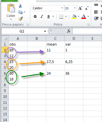

i need this:
- meanvar.png (30.38 KiB) Viewed 11009 times

for example: i have 6 obs 10 12 15 20 30 18
the fisrt mean = (10+12)/2=11
the second mean=(15+20)/2=17.5
the third mean=(30+18)/2=6.25
i need this: (x+x(-1))/2, (x(-2)+x(-3))/2,....etc
but @movav(x,2) calculate the first mean like this(x+x(-1))/2 = (10+12)/2, for the second (x(-1)+x(-2))/2 =(12+15)/2,....etc

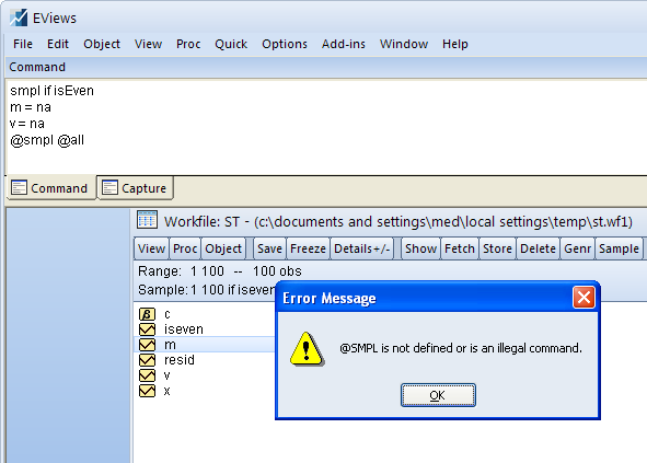

because it not work, some error message appear
1)series isEven= 2*@floor(@obsnum/2) = @obsum (@obsum in not a genr or series expression function)
2)@SMPL @all (@SMPL in not defined or is an illegal command)

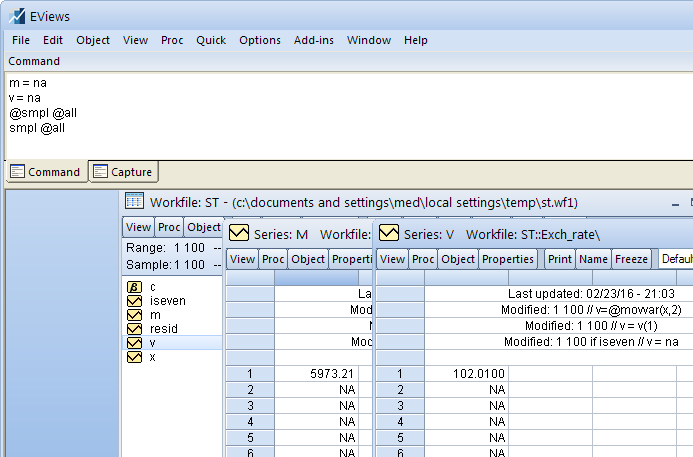

i have followed the code step by step Mr startz by i get error (@SMPL in not defined or is an illegal command ) but if i use smpl @all the code work; and i get just the first mean and variance of the two obs. what can i do this is my workfile.

- mv.png (26.48 KiB) Viewed 10869 times
- error.png (24.16 KiB) Viewed 10869 times

The code I posted does not say "@smpl"
I suspect that you may still be suffering from typo problems. Computers are pretty literal minded, so trivial errors can really screw things up.
